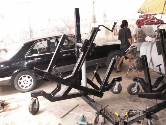

I used 10" pneumatic wheel at the rear and two solid rubbers up front.
To prevent the flat spotting of the wheels, I installed screw jacks to handle the weight of the vehicle once it has been mounted.
