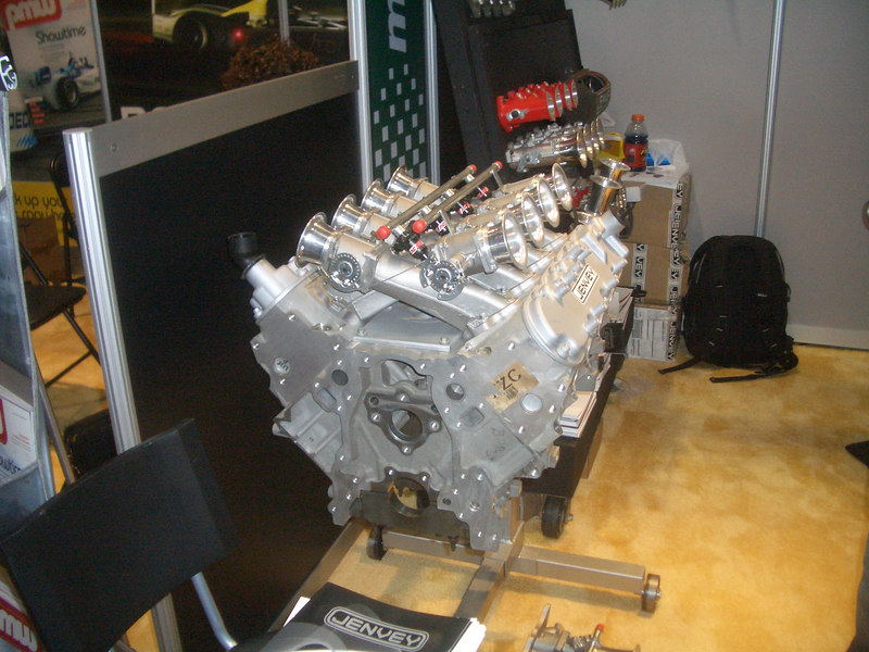

Picture of the unit:
Anyone got any more information?

WOW that's nice looking

$$$$$$$$$damn$$$$$$ that thing is sweet

That Barry Grant unit looks nice
