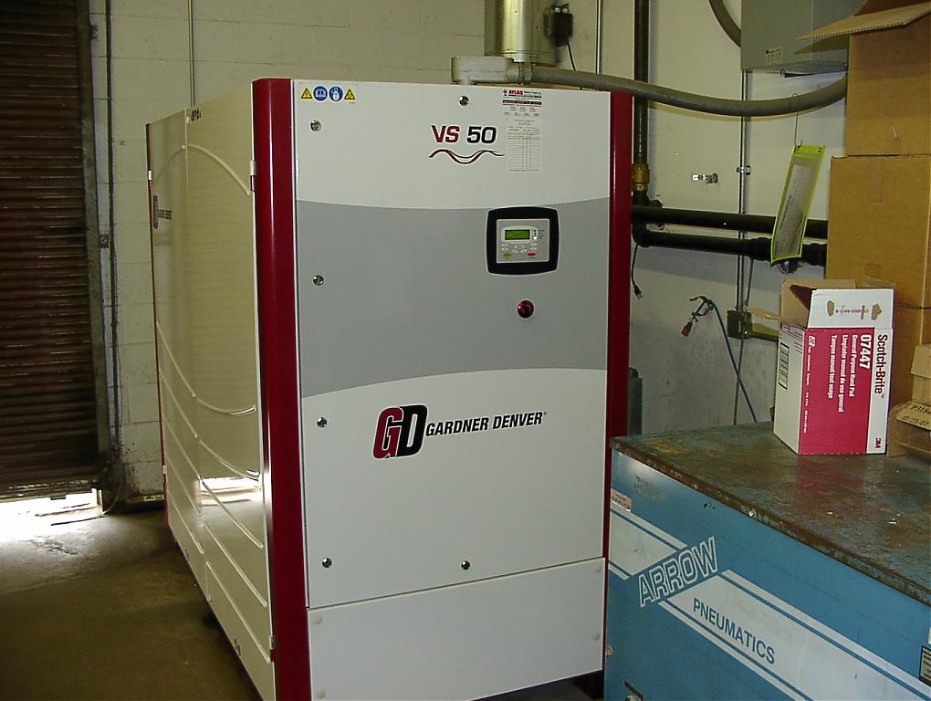

We started off with a 7.5 hp/27 cfm, worked great until we got in to blasting
the new one is well just a lil fella at 360 cfm
7 ft tall, 10 ft deep, 4 ft wide, computer controlled variable speed blah blah blah
Screw is the way to go, lower operating cost, less noise, more efficient maintenance is easy.

wow street works shes a beauty!!! id love to have that in my shop!!
