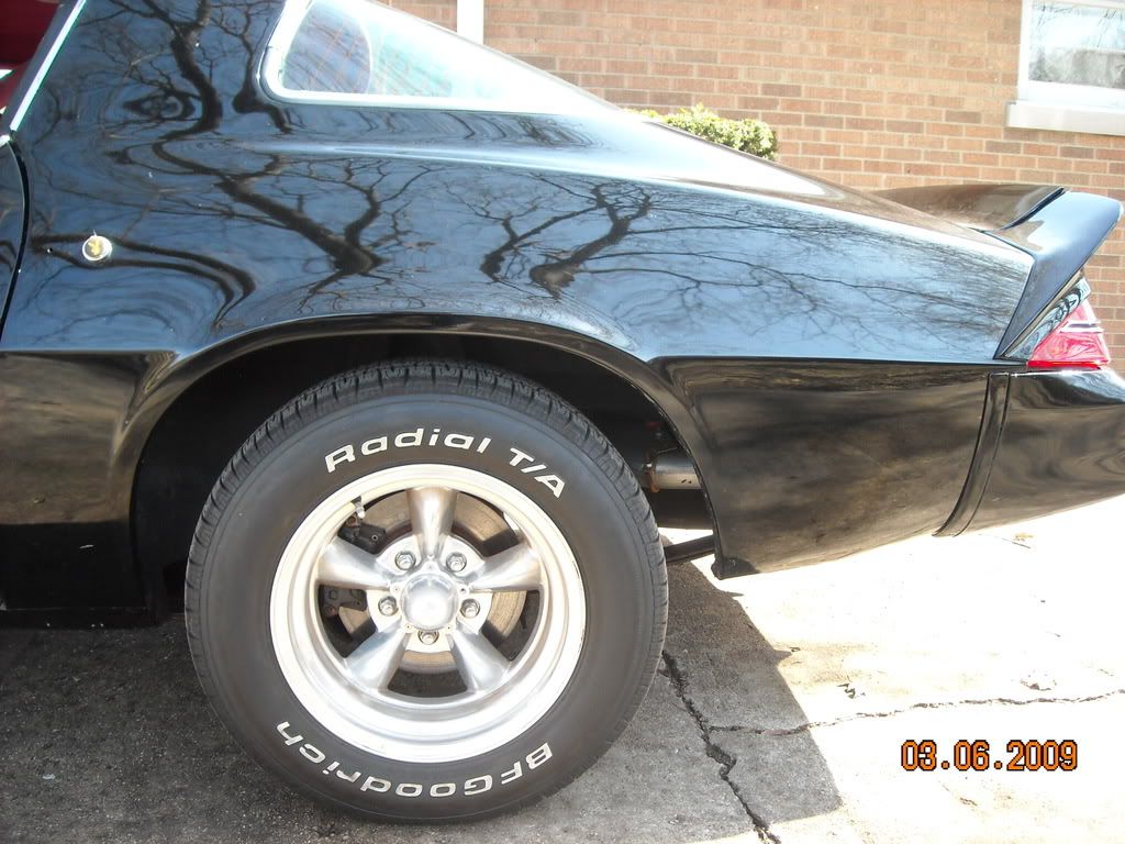

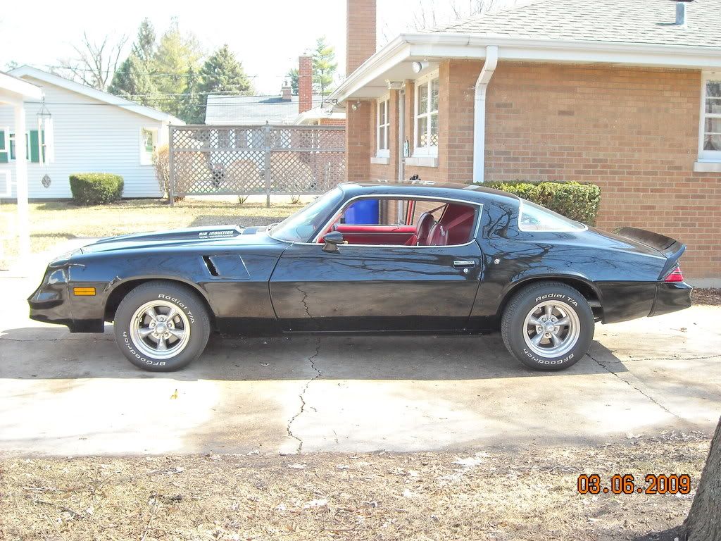

I just joined this forum and this is my ride. It's a 1980 camaro that was originally a berlinetta.

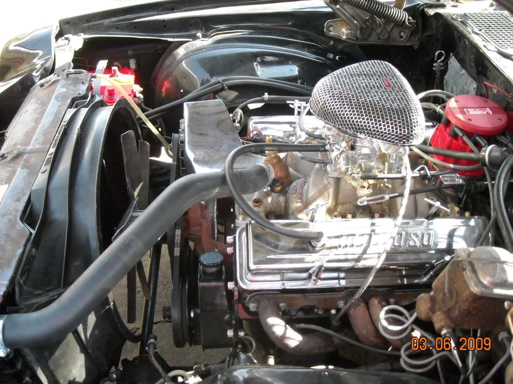

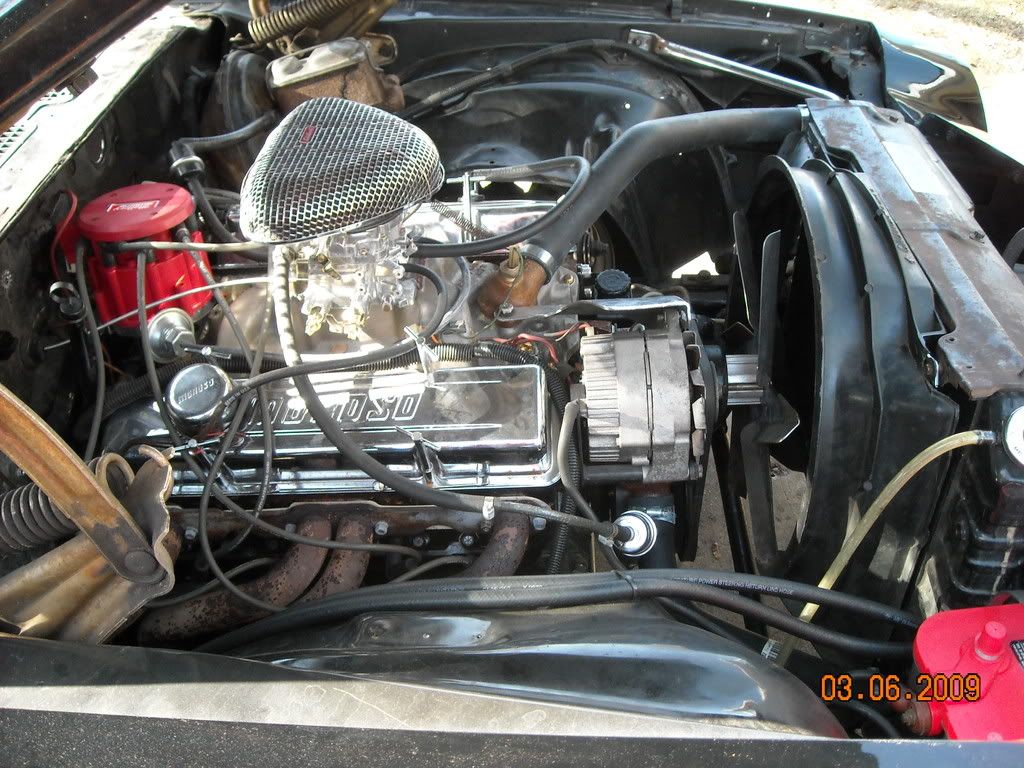

I bought it with a 350 already swaped in for the 6 and then I swapped that 350 for a .30 over crate motor with four bolt mains, hyperteutectic pistons, dart iron eagle heads, and a comp cams 268/280 .477/.480 cam. I finished the engine with an edelbrock 600 cfm vacum secondary manual chock carb and a Mallory HEI
It also has hand me down headers, a 2.25 in dual exhaust w/o cats, and a red top Optima battery.
I have had the car for five years and it has always been garaged with a cover on it. It also has 4 wheel disks and 15iich Torque Thrust style wheels w/ radial gt's
The car is in pretty good shape outside and inside as well. I really like the black on red color combo.
I am looking forward to hearing what you guys think. Any comments or advice would be appreciated. I am right now in the process of researching some suspension upgrades. I am leaning toward Hotchiss lowerinsg springs and new shocks, and sway bars.

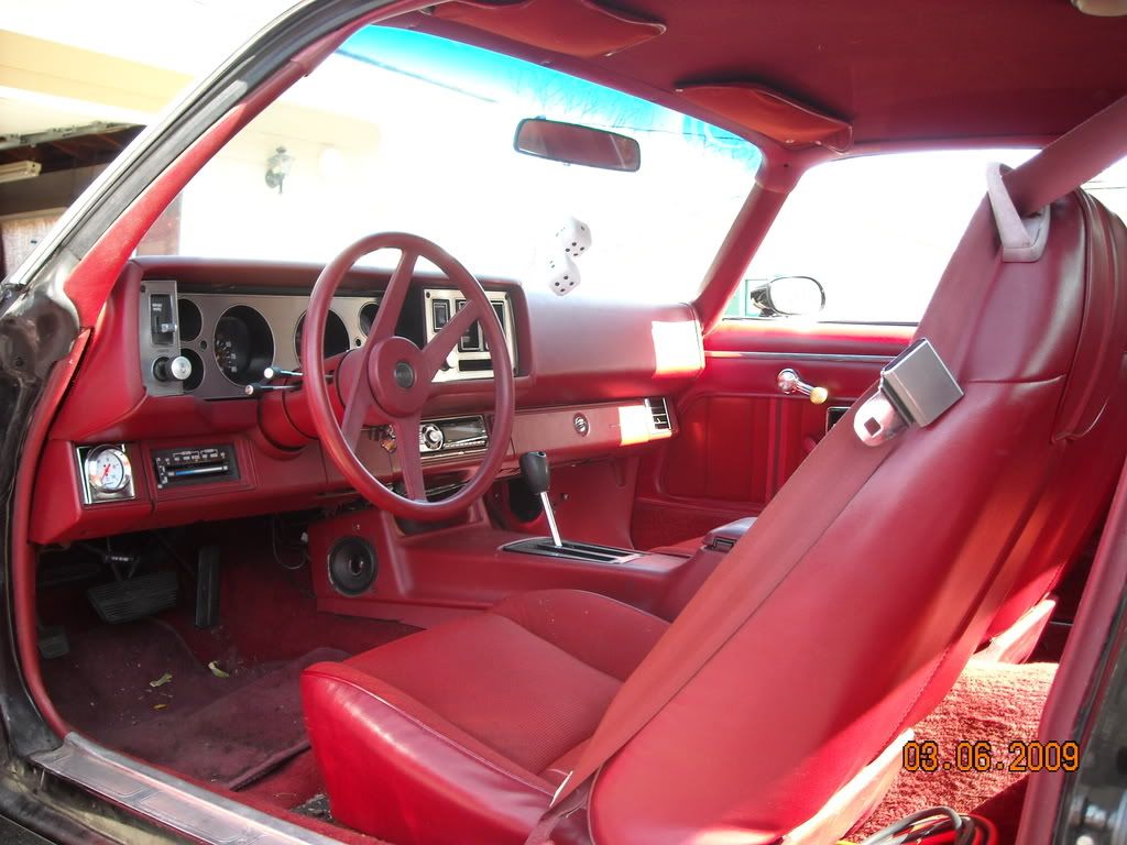

When I bought it someone had already installed a posi and 3.73 gears, so I am all good there. The playboy thing is a starter disable. I takes a small round key under the playboy symbol. I would remove it but then I would have a hole in my car I looked at your car and its really nice. I started with drag ambitions myself, but having a car a car that is quick and can handle is the way I'm trying to go. Over bumps my car rides terribly So suspension is my spring project! What is your set-up?

Nice, just needs to be lowered a little.
If you are bored one weekend, I would pull the engine and paint it and paint the headers.
