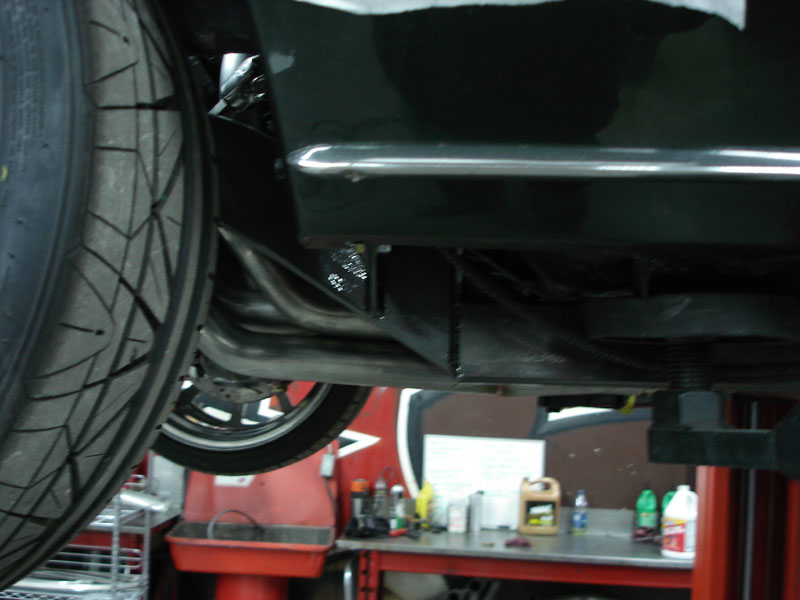

Have a look at our test car, it runs 19x10 with 275/30/19 and 20x12 with 345/25/20 (mini tubbed obviously) the ride height (with our Stainless Works headers) not on the car in this picture .but the pic below shows a side shot compared to the sub frame. actually the oil pan is lower than the headers. is very agressive. if you didnt want it as low as possible then there is always that option as well.

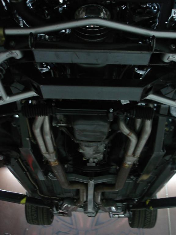

QUOTE Rear suspension - I happen to be a fan of the torque arm setup in my 99 SS. The torque arm setup looks good too but same story. I havn't seen too many people with this (realize it's new) but would like to see installation pics
See pics below.

QUOTE I would also like to know if this torque arm setup reduces ground clearance
NO it is not even as low as the mufflers which are almost 2" lower than the arm.
