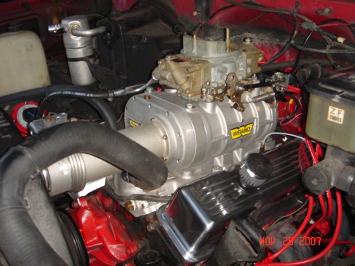

I can't address your clearance issues, but here is a 142 I put on my Blazer. It has 8.5 CR, mild blower cam. I have two pulleys, one for 5.5 psi, the other for 7.2. The carb is a Holley 800DP, modified for a boost referenced power valve. Jetted 2 sizes larger and confirmed good A/F with an Innovate Wideband O2 sensor. I run 93 octane gas and have not had a detonation problem yet. The torque is excellent. The hp dies right at 5200 rpm and the boost goes crazy since the heads are stock and they are at their airflow limit at that point. Completely maintenance free. Oh yeah, this vehicle has both a v-belt AND serpentine. Just order which blower snout fits your needs. 6500 - shortest, 6504-longest.
