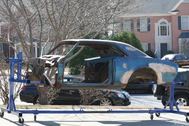

Default AutoTwirler
Here's a pic.
Dave
'67 RS/SS Camaro - current project
'72 Nova

In that picture it looks like there is a lot more room to work on the firewall than I had thought. Are those their standard mounts or something you made?
