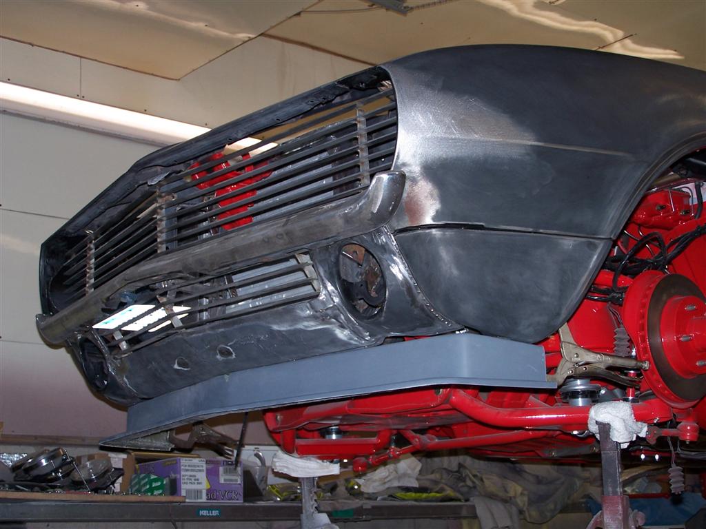

the lights are going in my 68 valance.do you guys just cut a hole and mount the lights behind it or did you build a pod so to speak for it to sit in?thanks

You could graft a set of light buckets from a 69 re-pop valance.

Ron's idea would be the way to go - you definitely want some kind of finished lip around the hole for the cutout instead of a sharp edge. The 69 opening would be perfect as it is identical to the profile of the lights.
The inner edge of the lip then gives you a surface to make a couple of mounting tabs for the lights.

the easiest thing to buy a 69 lower valance and cut the holes from them and graft them to my lower valance/who has an extra i can chop up?

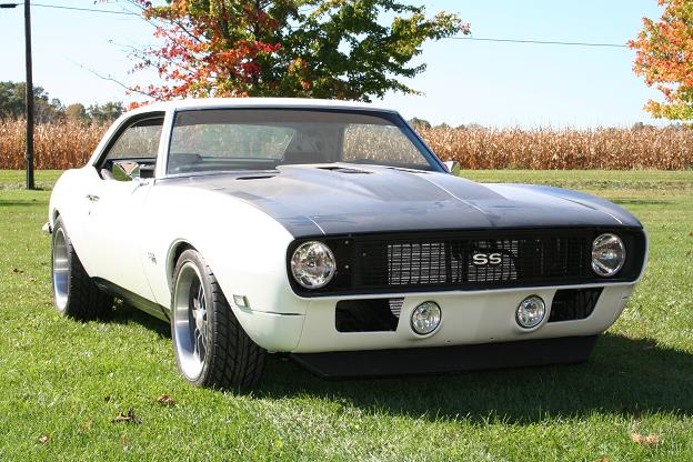

Default here they are

nice pieces! I have them too!

wow...nice clean front valance...looks killer!
