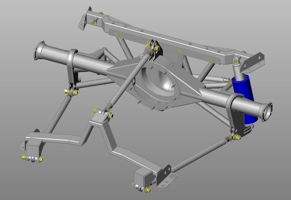

***Rad: I don't think you need to worry about the debate between four link setups, and three link setups on this forum, it is pretty simple to show the benefits of a three link over a four link. Technically, what it sounds like you have is a torque arm, and though there are three physical links on the system, it behaves quite a bit differently than a "three link" (the main thing being that the center link on a torque arm is rigidly mounted to the axle assembly, whereas a three link is joined via a bushing or link, and is allowed to rotate in bump/droop).***
Attached is a Solid-model of the Lateral Dynamics Three Link setup, all of the work was engineered in Solidworks software, including strain/defelection analysis on critical points. We use Bill Mitchell's WinGeo to model the actual suspension kinematics for those of you familiar with the software packages available. This design is an "improved" version of what has been in our test mule for nearly a year now. Improved, meaning the brackets and other aspects are a bit better thought out than the prototype, but the suspension geometry is the same, and we are pretty proud of it.
The setup has yet to be installed on a customer car, though two cars are in the process of installation at this time (one first gen on the east coast, one second gen in our shop in California). Both cars are on rotisseries, and will serve as the basis for generating an extensive installation instruction and setup guide. The setup is commercially available right now, though due to the SEMA show, deliveries will be a couple weeks out. We had some issues finding reliable suppliers early on and that cost us a good amount of time, but we now have found reliable, capable folks for the elements we don't have the tooling to build, thanks to some key contacts from friends in the industry. All of the crossmembers, brackets, and most importantly, the rear end assembly (9" Ford based assembly) are fixture welded by us, I am very confident that you will be extremely pleased with the quality. You won't have to fuss with welding brackets to the axle tubes and needing to straighten things afterwards, we take care of that for you. Installation is not terribly complex, but does involve some careful cutting, and of course, welding of the crossmember brackets. It is no more complex than installing a set of mini-tubs, or through floor subframe connectors.
The kit is a very complete setup, less components that are very customer preference specific. Namely, the center section/differential/gear setup, axles, and brakes are not included. The reason is that there are so many options, it would be very difficult for us to stock all of this at this time, though we can recommend and supply these components as an option to the kit. Brakes are based upon the highly popular Corvette "C5" configuration, so any commercially available C5 kit will work, from the very good, budget friendly GM parts, to aftermarket endurance race setups, and anything in between. The base kit comes with a set of Bilstein mono-tube coil over shock absorbers, custom valved for our application so you don't need to fuss with setting. A matched set of Hypercoil or Eibach springs is also included. Penske Racing Shocks are available as an upgrade, and though relatively expensive, these shocks are generally regarded as the best practical racing shock, and are highly supported: you can't go to a track these days and NOT find someone that can rebuild/service Penske's. The model shown has heim/rod ends in all pivot locations, however, high durometer rubber bushings are included on the base kit to help keep road noise down. Rod ends in all locations are also available. Because we control all aspects of the design, custom width rear ends, full floating axle-hub setups, and other configuration are all available.
Our website is under construction, we will have a temporary one up in a few days with more details and pictures of the setup. We will be at SEMA with a booth (#52425) and a display setup, so if you attend the show, please stop by and say hello. I'll drop some pic's of the hardware here in the very near future.

Mark that is a nice set-up! Are you going to be doing anything with A-bodys...just wondering!
Looks great though
