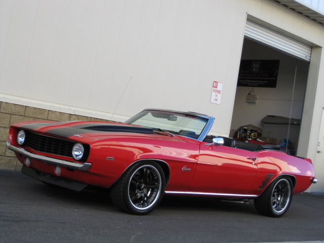

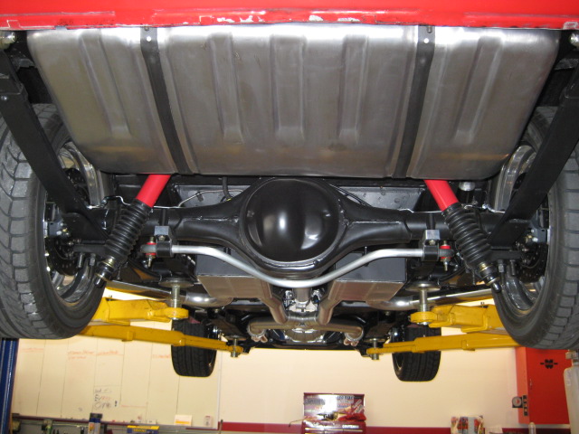

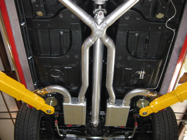

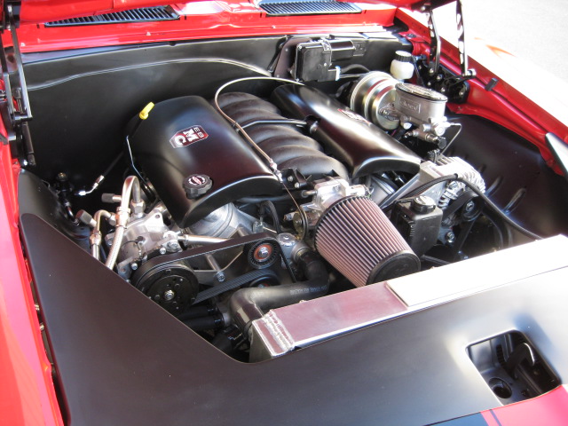

Thought I'd share a couple of pics of a Camaro project we just finished. The car came in late feb. for a tune up and some lighting upgrades. Well, the target master motor was running on 7 cylinders and leaked everywhere. The suspension was old and tired and electrical system had the usual 40 years worth of stereo shop molestation. One thing led to another and we decided to do everything but the paint and interior. Including.... LS6, TKO 500,with hydraulic throwout, narrowed 9" with inboard shock setup, SPC upper and lower arms, IROC box, hotchkis springs and bars. We also replaced rusted out upper dash, filled firewall, Rewired car and installed vintage air. Jason Rushforth set us up with some Superspokes 18x9 and 18x8. We also decided to go a side exit exhaust. Oh and we did upgrade the lighting with some Led tailights!

the car looks great! Nice clean car

Looks good!
Not a fan of the side exhaust, but looks really good.
