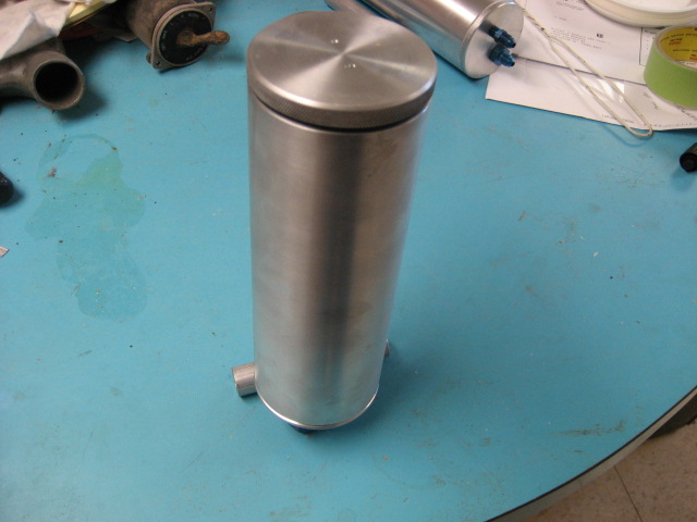

Just receieved my HB a couple of days ago and I am wondering what remote power steering pumps are people using for their setup? I looked at Zoops, PSC Motorsports, Detroit speed, etc. and am not sure which one people are having the most success with. Must have the proper pressure relief, gpm, etc. I have a 385 small block chevy 6++"/7++" roller cam, aluminum everything, ZEX, T&D shaft mount, and need help with pump selection and proper bracketry (plan on using PSC resevoir for Hydroboost). I do not want the bulky look of a Saginaw pump. Thanks!

Can you wait a couple weeks? I will be releasing these along with matching overflow tank. They have been track tested with excellent results. Dual -6 returns, -10 feed, will have a billet bracket available as well.

What accessory drive system are you running? Most all use Type II pumps. I am partial to Wegner drives which is also DSE. If you running stock bracketry AGR makes a saginaw pump with a welded on remote can and works well.

Meziere elect. water pump, so i's only power steering and an alt. that's it. Probably just a matching serpentine system from March Perf. Most likely will use their remote ps pump pulley. Seen DSE but since their resevoir only has (1) output and input (must weld an extra one) may stay away from it. I like yours as well, will they have any of your decals on it so that I can show it off without having to say who makes it?

There will be no engraved logos on the tanks. There will probably be a logo on the bracket, but that will be easy to turn over and hide.
