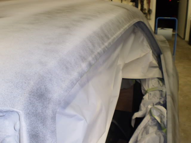

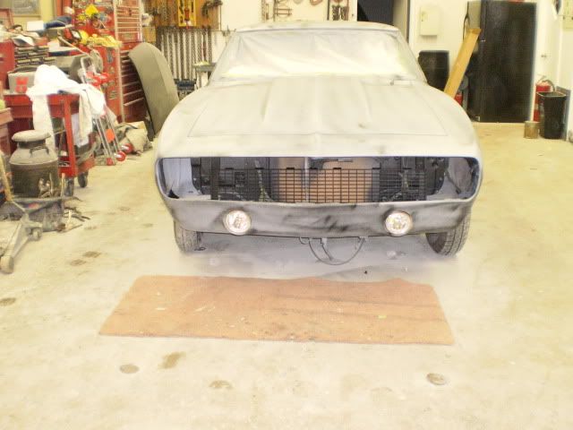

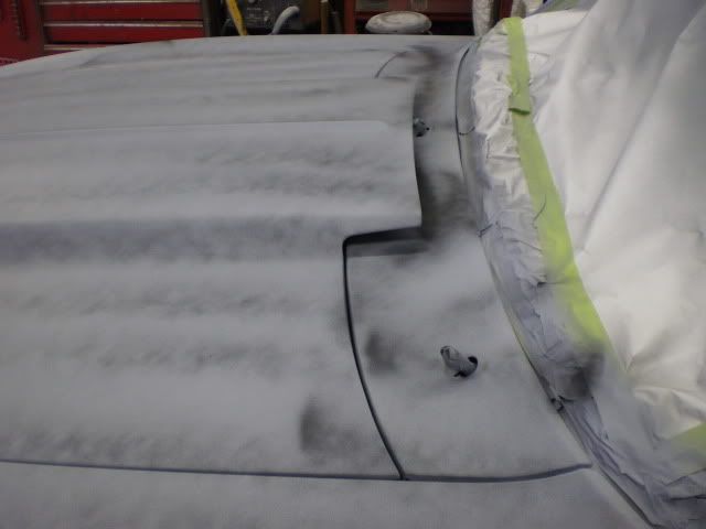

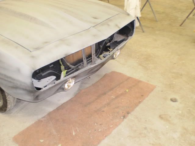

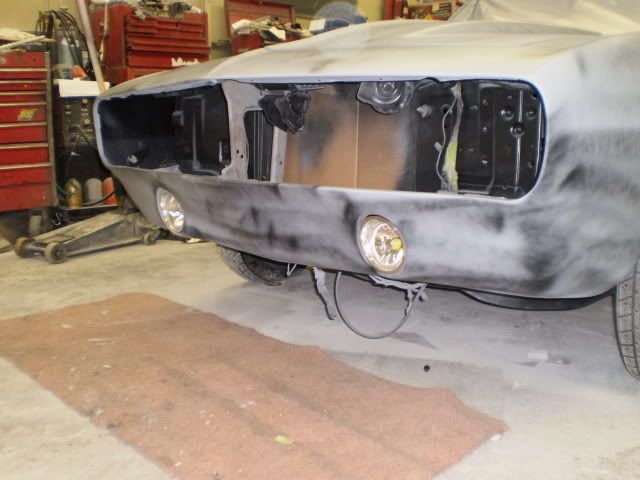

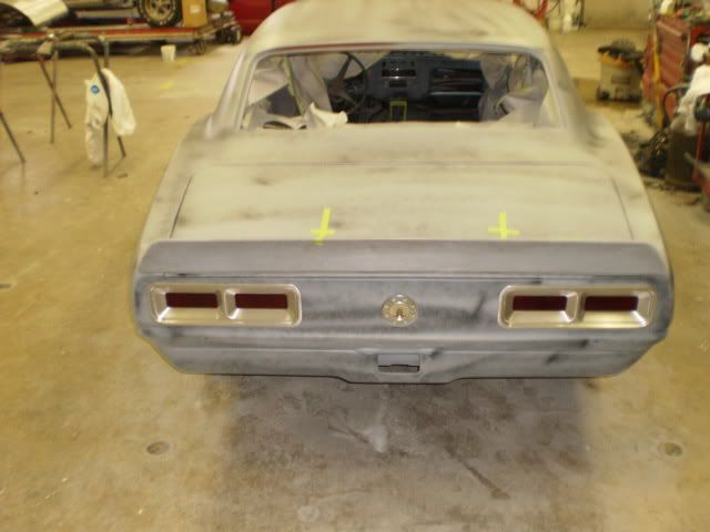

gonna start blocking it this week/i need a final color choice real soon.i hope you all like it.give me some feedback good or bad/thanks

I like all the mods...very smooth looking! Pics are pics of course...but I think it looks great so far! What do you think, one more round of sanding?

I wanna see the post blocking picks. Use long blocks and light pressure and change the paper often. Yeah right, like Im am telling you anything LOL Im sure you know exactly what you are doing.
Dont cheat, show all the highs and lows That might determine the final color too (light or dark), unless you are ready for another round with the build primer.
But just looking at the flat primer thats there she looks pretty flat. The block will reveal ALL though. I found this out.
When I blocked my car I ran into some low and high spots. It was an eye opener, one that I didnt want really. I have alot of work to do.
I hope you get a nice flat sand. Cant wait to see the post sanding pics. JR

I like how the drip rails and cowl area turned out. It looks good.

The old rule comes into effect here. Dark colors hide nothing, light colors are more foregiving. That should help you decide which direction to go depending on the body as a whole.

I missed the drip rails the first time I looked at it. I too like that.
