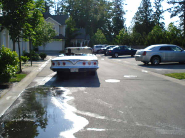

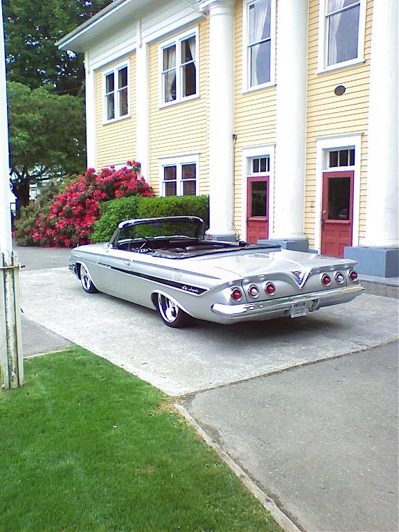

Hello there, I am kevin and own a 1961 ragtop Impala. Here are my specs....

sweet car. looks really good.

Nice car!

First -- WELCOME! Nice Impala!

Welcome aboard!! Very nice ride!

Welcome!! Nice ride!!

I love the Impala 61's & 62's simple for the smaller body. I want a 62 so bad. keep her looking good.

sweet!!!! love the early 60's impala's.

Very clean ride my man!!
