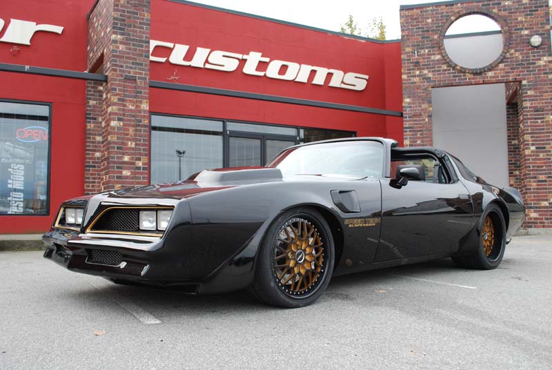

we ended up with a 19x9 and a 275 on the black trans am the back space was 6.5 we used our upper and lower arms and Baer brakes with the drop spindle. our arms have adjustable steering stops to prevent the wheel contact. also the car is really low and we pulled the front wheels in a bit to get it that low

I love the stance on this car. What is the rear wheel and tire set up?

this was a very nice looking car

rears are a 19x12 with a nitto invo 345/25/19
