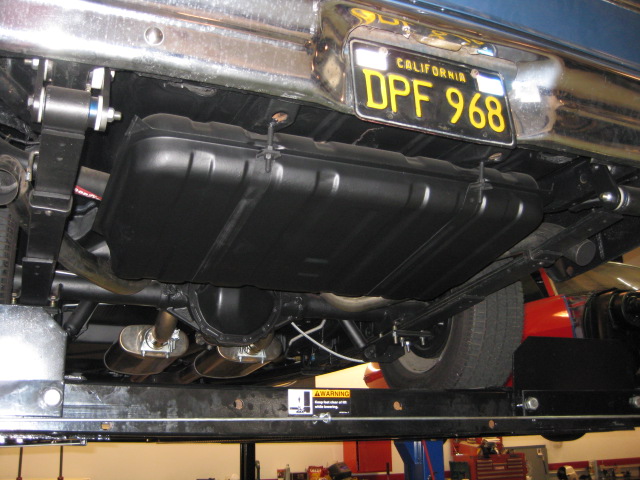

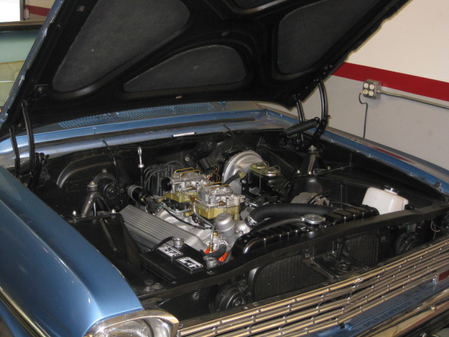

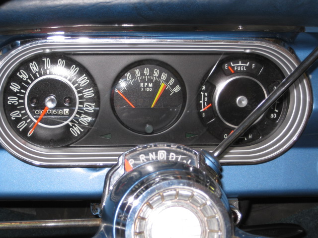

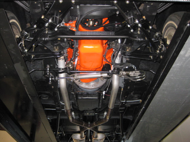

Thought some of you might be interested in this 62 nova convertable were finishing for a customer. Not high tech , but pretty cool. Originally a 6 cyl, powerglide, he wanted to give it a retro 60's look with a few modern conveniences. We refinished the underneath, installed subframe connectors, 3.73 12 bolt, new suspension with Global West Del-alum bushings, strut rods ect. 67 power front disc brakes, and 67 power steering. We found a 283 nova block and did a mild build with Edelbrock performer cam and 9.5 c/r. with 461x heads topped it off with a restored 61 vette dual 4 setup and disguised a full MSD ignition system. We also had a custom gauge cluster made (140 speedo and 8k tach). Its also got a 200r4 trans as well. No overall shots until we figure out a wheel and tire combo! Suggestions welcome!
