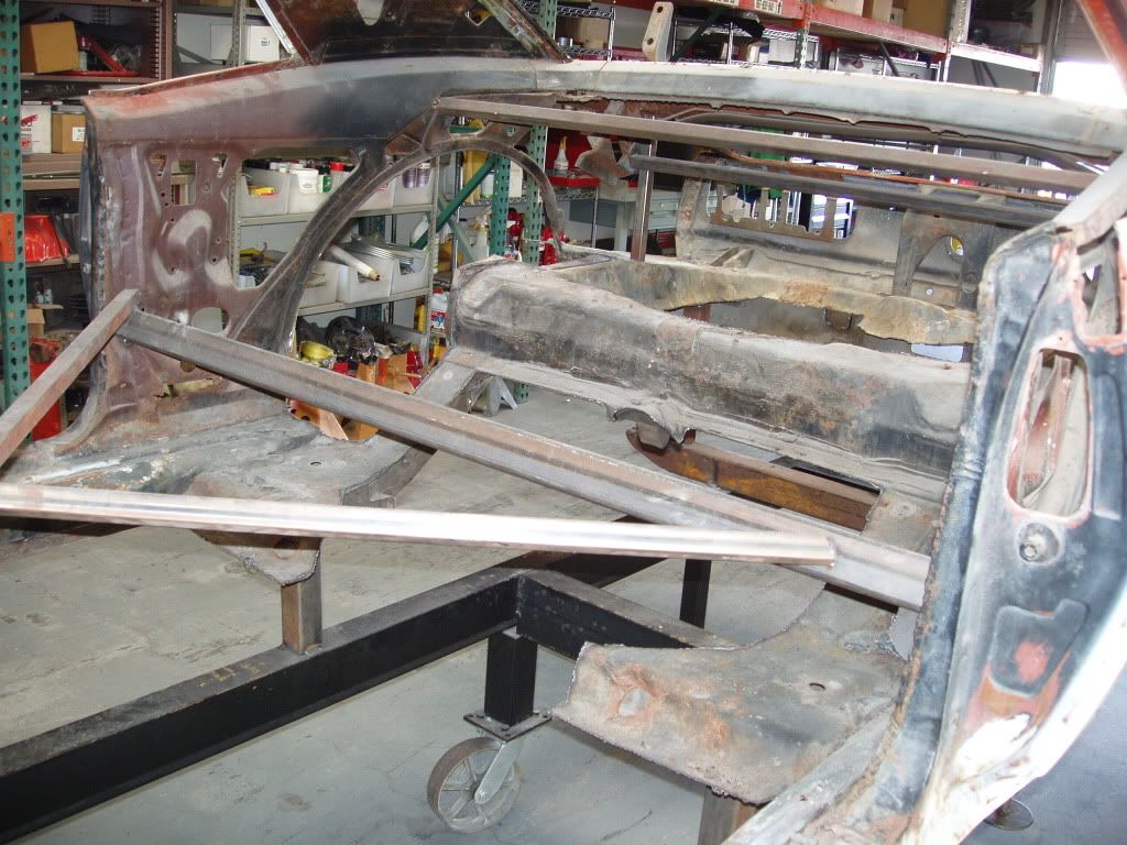

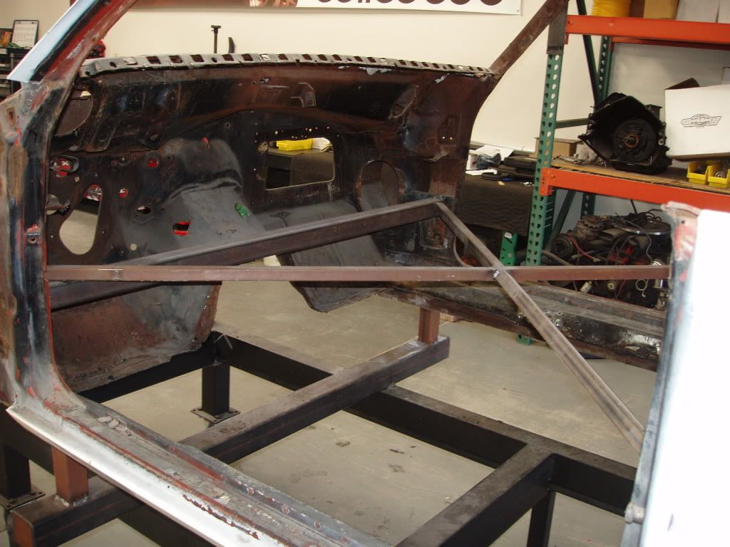

Here are some photos on how I brace a car when I am replacing complete floor boards. We cut out the floor & the trunk & left material on their that will be cut out when the shell comes back from media blasting.

The body is loaded on the cart half assembled with my 2 post lift.. Then we square, measure & weld the body to the cart.. This 68 Camaro will have custom suspension with floors & will be pulling the qtr panels to widen it up with tubing for some fat tires
