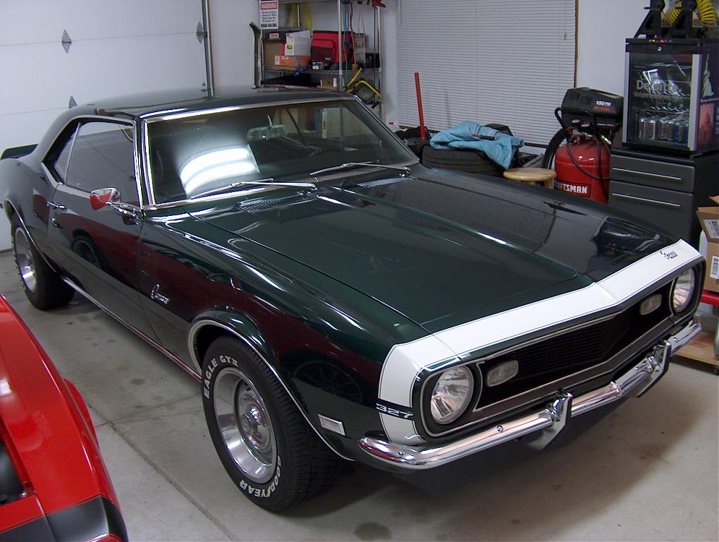

My dad spent a week this summer driving my 67 with it's newly installed Wegner L92. This prompted him to search for his next project. Being an old drag racer, he never got over the feel of horsepower.
He found this 68 on ebay and today we thought we were set to complete the heart transplant. What better way to spend Thanksgiving than wrenching with your pop?

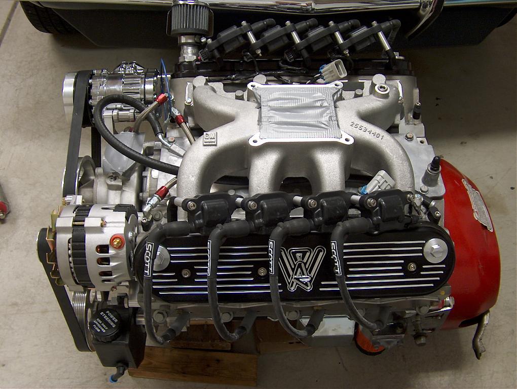

We got the old 327 out in short order left the transmission connected to the crossmember with a jack under it and started prepping the L92 for its new home. Some of you may recall, he wanted to keep the 4 speed and it's mechanical linkage. We found a nice bracket with the mounting ball from Scoggin Dickey and bought a package from Jegs with Hooker long tubes, motor mount plates, and aluminum radiator. While mocking up the header with the engine out of the car, we found that the rear primary on the driver's side will need to be moved so it will not interfere with the z bar. Not the end of the world, but a problem we did not anticipate.
The bigger problem came when we went to drop the engine in. When we got it dropped on top of the motor mounts we found that the transmission was about an inch from where it needed to be to bolt it to the bellhousing. It seems that the engine mount plates (Trans Dapt brand) that came in the package with the headers put the engine too far forward. I have ATS plates on my 67 and the back of the engine is pretty tight to the firewall.
