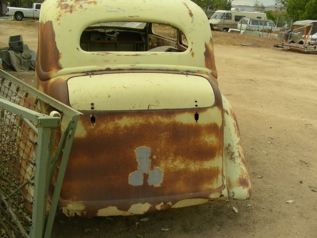

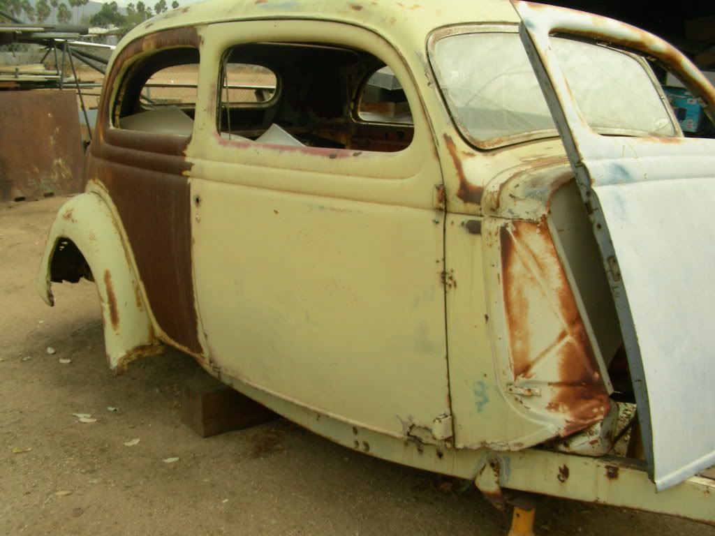

Some of you guys remember me whining about my deuce not long ago.. and since i just got a temp job the next 2 months before i start my new one in march, i figured it was time to look into a project... (ive been beating myself over the deuce i sold every day.. and the PT-malibu, drives awesome.. but it just isnt as close to my heart as the old streetrods... )
so i have this stuff left over: 1 Ls1 engine, heads cam etc 535fwhp. paddleshiftet 4l60e, pt converter, vintage air magnumIV.. etc etc...
and i found a nice rust free 35 ford hump back with wood replaced.. The guy i bought it from has an old school hot rod shop and he will chop it 2.5 inches ,cut and fit doors,roof,finish all welding,cut down window frames.. and hang doors suicide style..
Ill be doing the frame, plan was to install the mustang 2 IFS with SPC arms and a shortened jag suspension... but i talked to my suspension parts pusher who offered to help do some suspension geometry enginering.. so im looking at doing C5/6 front and rear uprights with some off the shelf arms.. but doing the x members in house and mounting the arms to get the handling as good as the malibu...
and with 450 rwhp it should be a fun car :-)

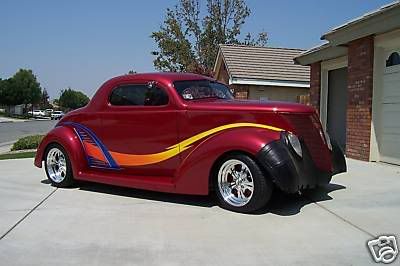

I have a 37 Ford MINOTTI project.... and I was going to originally install a C4 Corvette IRS... but every single frame guy I talked to said "DON'T DO IT"... It's not that it's complicated or expensive... their reasons were more about suspension geometry and ride... mostly to do with the narrowing of the half shafts etc. So I know have that IRS (a nice Dana 44 Hvy duty unit with 3:42's) rolling around on a dolly. Any takers? LOL
Anyway - I had a local shop build me a whole new chassis after discussing this chassis with every shop that builds 'em. I talked to RS - Pete and Jakes - etc...
I wanted a "driver" - put stuff in the trunk - the wife in the passenger seat - and head to San Diego... So I went with INBOARD mounted leaf springs - a Currie Ford 9" with Strange nodular 3:73's - Speedway Engineering torsion style sway bar - Heidts Superride front with coilovers - Wilwoods all around - including manual master (floor mounted) and a power rack... They talked me into the leaf spring rear end because then I can load the trunk up and not be bottoming out etc... so we'll see... I'm keeping my finger crossed. I've got an LS6 that I'm going to use - but I'm going to carb it I think... So super simple hot rod... with a 700r4 that I have...
Jason Rushforth has to come up with new paint and wheels etc... this is so old skool suck... but I bought it just as a project so didn't care.
