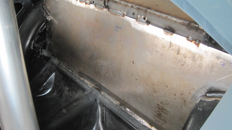

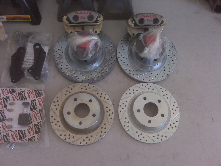

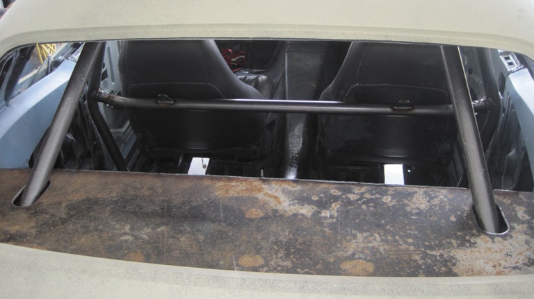

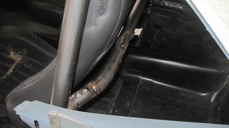

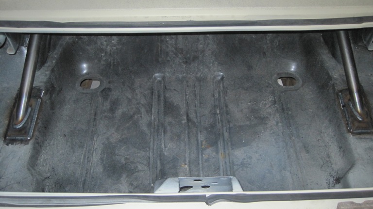

Thought I would post up a few pics as my car develops. I hope to have the car done by the end of 2010. Already completed most of the hard part. Installed the one piece floor, Full qtrs, tailpan, trunk pan, DSE Minitubs, smooth firewall, 4pt cage with removeable back bar, 1/4 inch plate in package tray area to stiffen the car up, removed the factory braces between the back seat and trunk area and installed a solid sheet of metal to mount my amp, speakers, computer, etc to backside of, removed factory dash speaker grille and put a piece of flat metal in, and up next once my wheels and tires get here and my DSE speed kit 3, I will be installing the DSE frame connectors. The car is going to have a big inch LSX engine, T56 trans, and Moser 12 bolt, vintage air, baer brakes on all 4 corners, DSE dash with Autometer guages, seats out of a 98-02 camaro recovered in black leather with a 5pt harness coming through the headrest area on the seat. Car will also have hideaway headlights as it is a factory rally sport car...

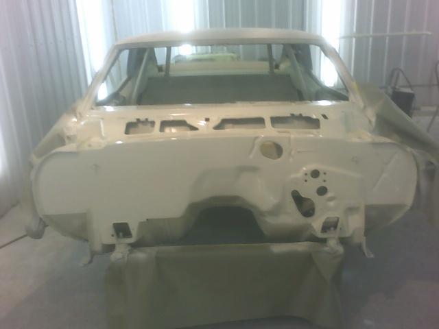

Well I made some progress... I got the body work done on the firewall, trunk area, cage, and the back panel between trunk and back seat that I put in and got it all primed. I will post up pics of it tonight.
Old 03-04-2010, 07:06 AM
firstgencam firstgencam is offline
Join Date: Jan 2010
Posts: 285
Here are some updated pics
