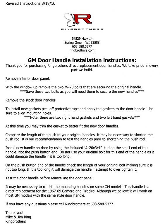

Hi guys! Sorry to post in here but I wanted notify anyone that has gotten a set of the GM door handles that we have an important change to the installation instructions.
A Nova customer brought up a valid point. Please see the attached instructions if you have the door handles.
The change is simply using a stud instead of your original bolt because on some makes your original bolt may be too long and break through the handle -on the smaller end of the handle. You can cut your bolt to make the stud or I am more than happy to send you out a stud.
If you would like me to send you the studs feel free to email me at [email protected] or give me a call at 608-588-5377.
We apologize for any inconvenience.
Thank you Mike for hashing this out with me until the wee hours of the night!
