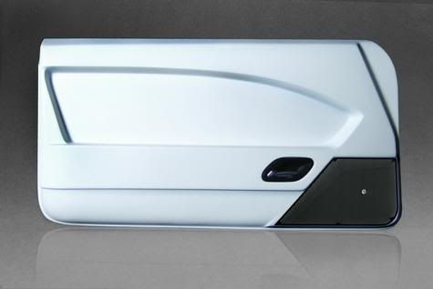

For the fronts, the 67's have the metal piece on the top part of the panel (part of the door) and are only about 3/4 the length of the 68/69's. I assume you have a 67, so here is a picture of a 68/69 style- http://home.coqui.net/borench/images/interiors_01.jpg

On the stock door panels, I understand the 67 has the upper metal exposed while it is covered on the 68 and 69.. Is the same true with the Marquez panels? I assumed the Marquez panel would cover the top metal on the 67 door as it does with the 68 and 69 as I haven't seen a picture of a Marquez panel that does not cover the entire door.

There really is no difference aesthetically, as others mentioned, there is a difference on the door shell inside.
We cover this with a slight modification to the back side of a '68 panel for a '67 door. It ends up looking the same as a 68 panel.
We actually did two of these this week.
