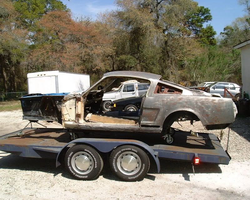

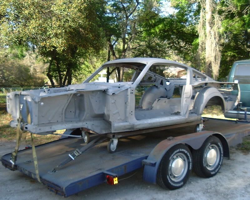

I just picked up this new project today. We will be doing all the rust repair, removing the drip rails, adding metal flares and a few more surprises.
Chris leaves for Iraq for a year and while he is there serving our country we will be restoring his fastback. I think the hardest thing for Chris will be leaving his son.

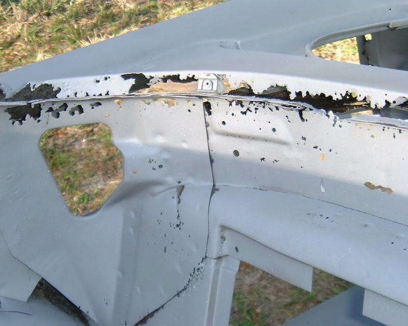

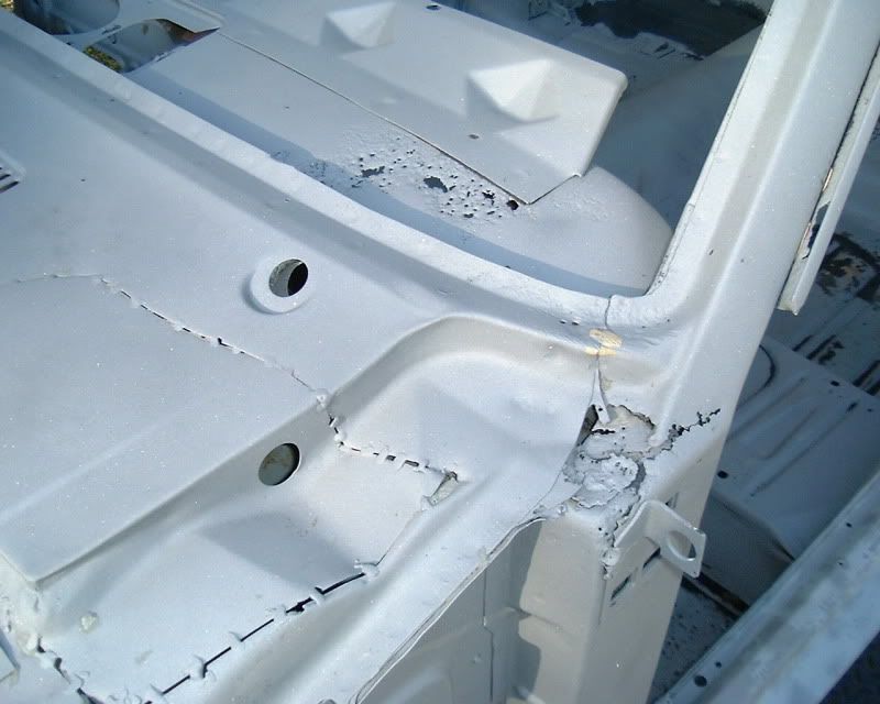

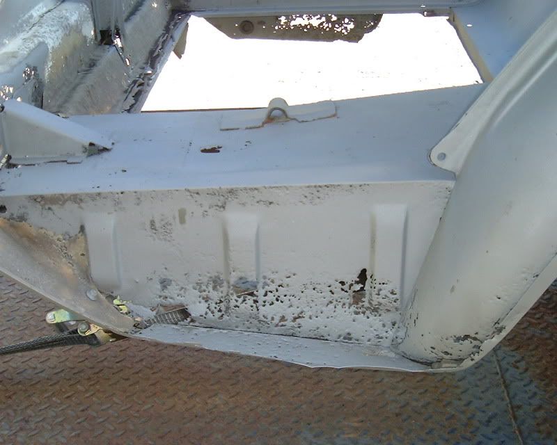

Back from the sandblaster it looks good from a distance
It had been patched with fiberglass mat so there is a lot of hidden rust. The first thing we need to do is repair all the rust.

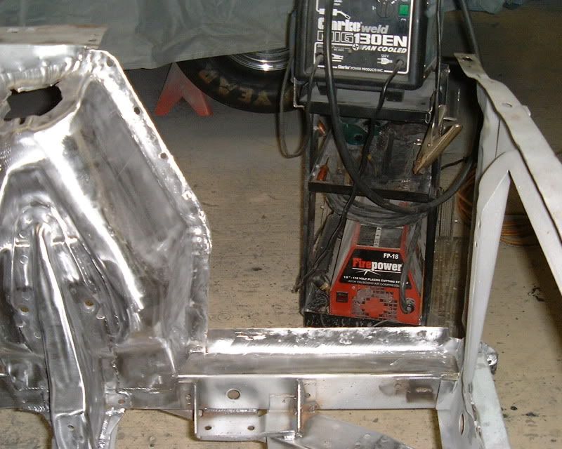

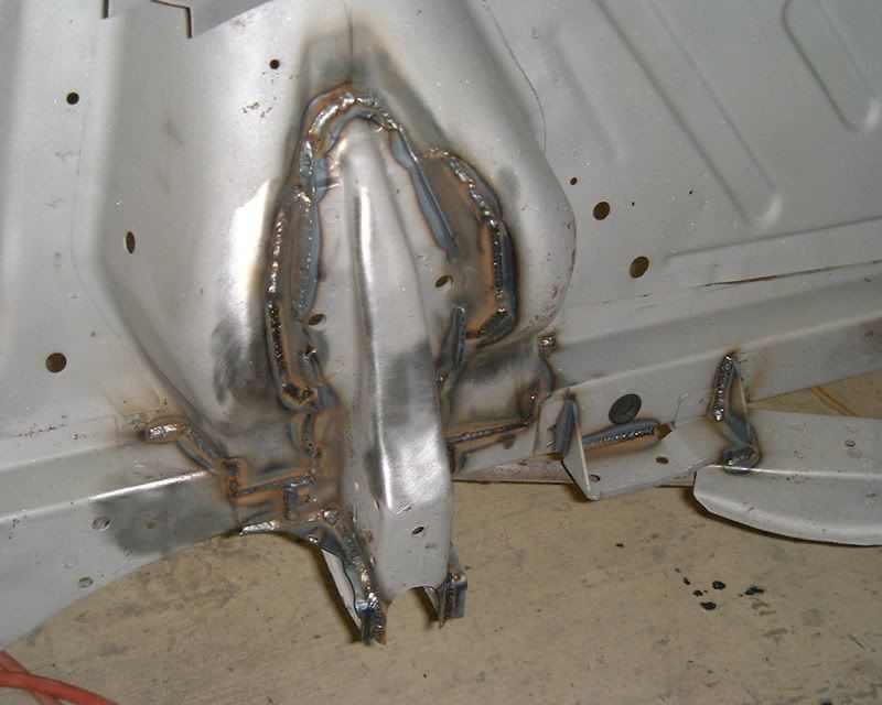

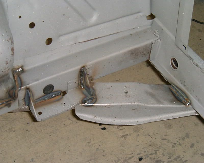

I had Brian weld the shock towers since we are going to be using Opentracker front suspension

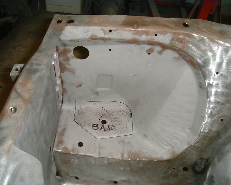

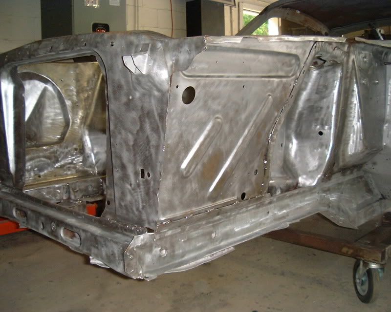

The fender aprons had been replaced at one time but they had not cut out all of the old metal and were not welded in some places. Brian removed the fender apron cleaned it up and welded back in and repaired a little rust.

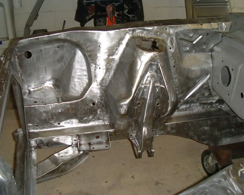

Thanked 12 Times in 11 Posts

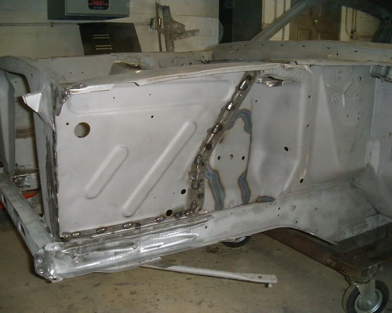

Brian finished welding the engine compartment and epoxy primed it yesterday.
