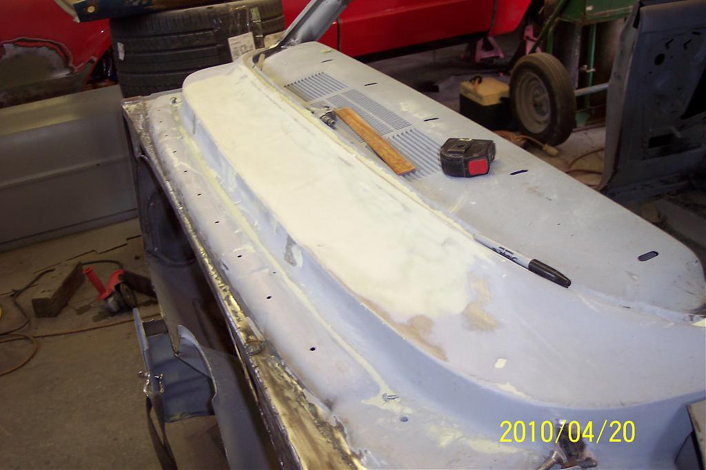

SOLD !!!!! car listed on this site Here is a link to my new project,, It's sure not a Novanutcase!! And just another Chevy II with a few mod's , 9" ford {triangulated 4 link} 2x3 perimeter frame, http://s231.photobucket.com/albums/ee291/69c4x11/

What are your plans for drivetrain,and what wheel and tire combo. I vote PROCHARGED LSX!!!!!! What front clip and will it have IRS since both of your last cars had it? It's gonna be a cool car Pops.

It looks like you leveled out the rain gutter. That has always been an idea of mine on those cars. I'm sure it will be bad ass like your vette when it is done.

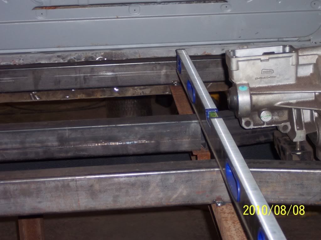

Roger;; Neal is giving me guidance... Still it all comes down to $$$$,,His brain has to many ideas for my budgit and skill !!! Check out this low budgit jig zero $$ ,,Can't beat the price ,Thanks Temple Inland,,, my emplorer,,

NO the aluminum ramps are just temp, til i get the tubing cut to the right length's,,It will have a 5" ride hgt, waiting on the front subframe,,then maybe can show some progress,

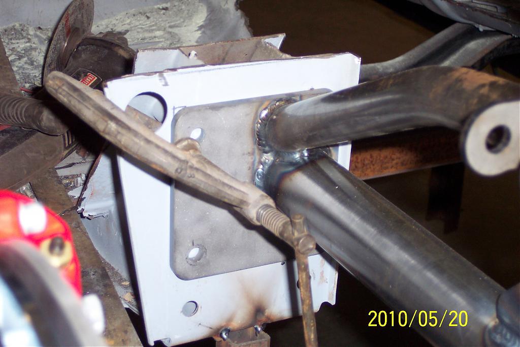

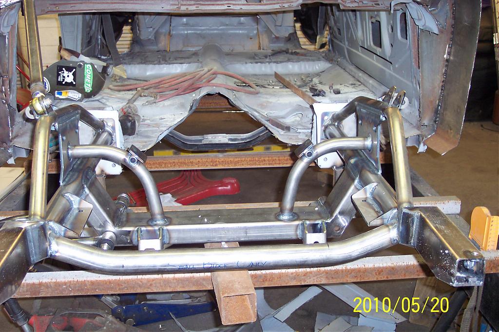

Default TCI PRO-touring subframe

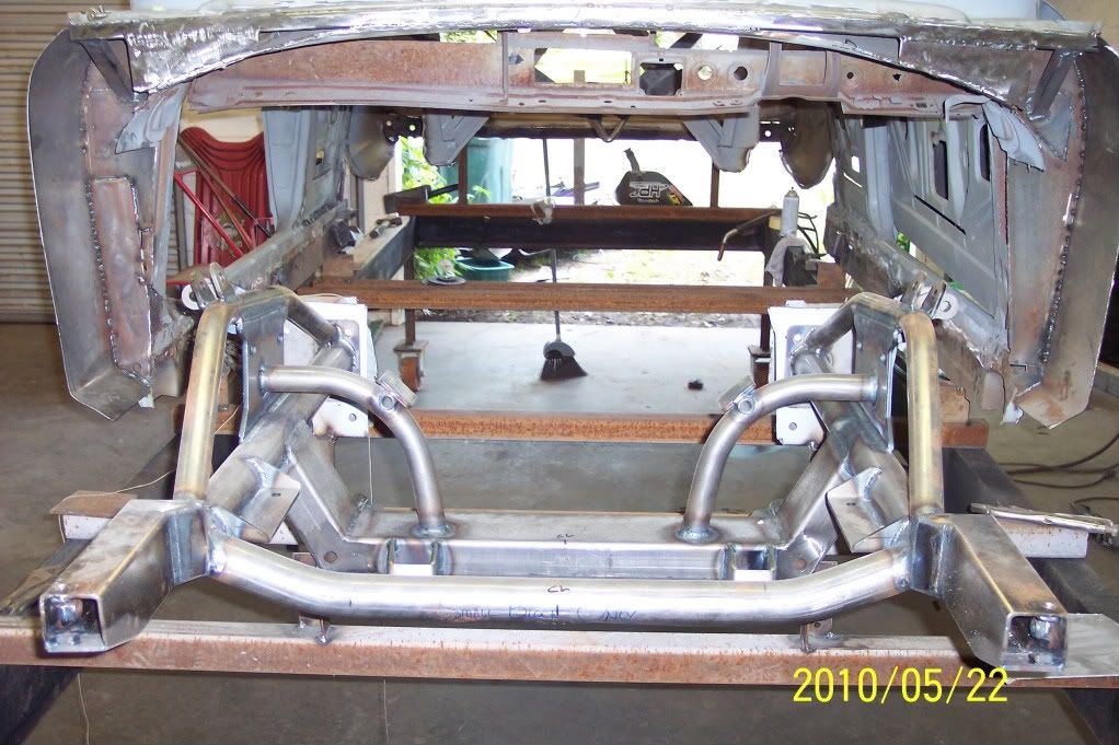

Pics of mock-up,,http://s231.photobucket.com/albums/ee291/69c4x11/

I hope you are going to be able to get it low enough to the ground to make the low roof line look proportioned.. Muscle cars always look weird chopped to me because the body is proportioned to the roof pretty well from the factory.. im looking forward to seeing how this comes out!

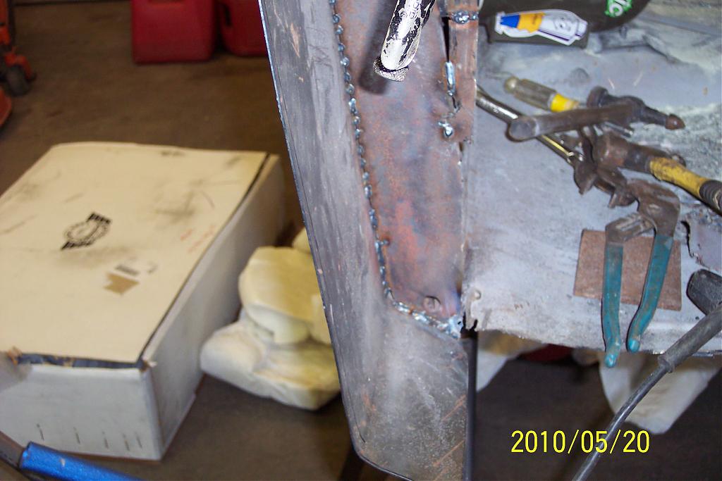

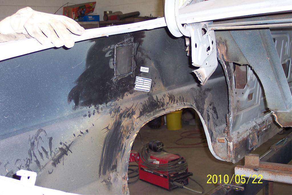

The top has already been cut, 7/8 on A pillar,3/16-0 on B sail panel,, do you think it looks out of proportoin now ?? Most will never think it's cut ??
