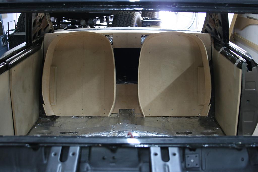

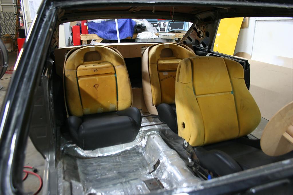

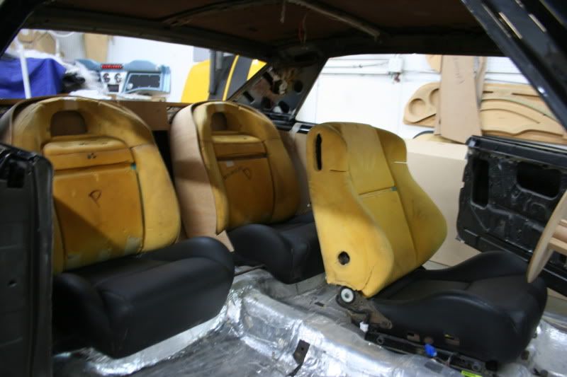

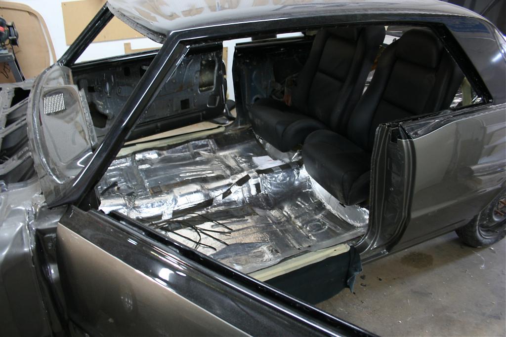

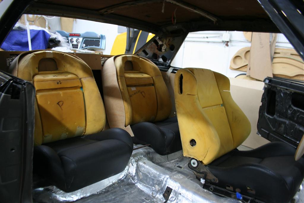

This might help out guys, here's a 65 GTO with front and rear 06 GTO buckets that have been modified, custom brackets and shortening of the cushions...... Forms are made for fiberglass which will later be removed.... http://www.hubgarage.com/mygarage

WE TOOK A SECTION OUT OF OUR REARS SO THAT THEY DIDNT SIT UP HIGHER THAN THE FRONTS, OUR HEIGHTS BETWEEN FRONT AND REAR ARE THE SAME....WE'VE ASLO GOT A CONSOLE GOING FROM FRONT TO BACK WITH A VERY TRICK SET UP WITH THE PACKAGE TRAY......WILL POST MORE PICS ON THIS IN A COUPLE OF WEEKS.....AS FAR AS DEMENSIONS GO, BUST OUT THE TAPE MEASURE AND TAKE YOUR TIME BEFORE YOU CHOP IT UP......AND DON'T FORGET ABOUT COMFORT.... GOOD LUCK
