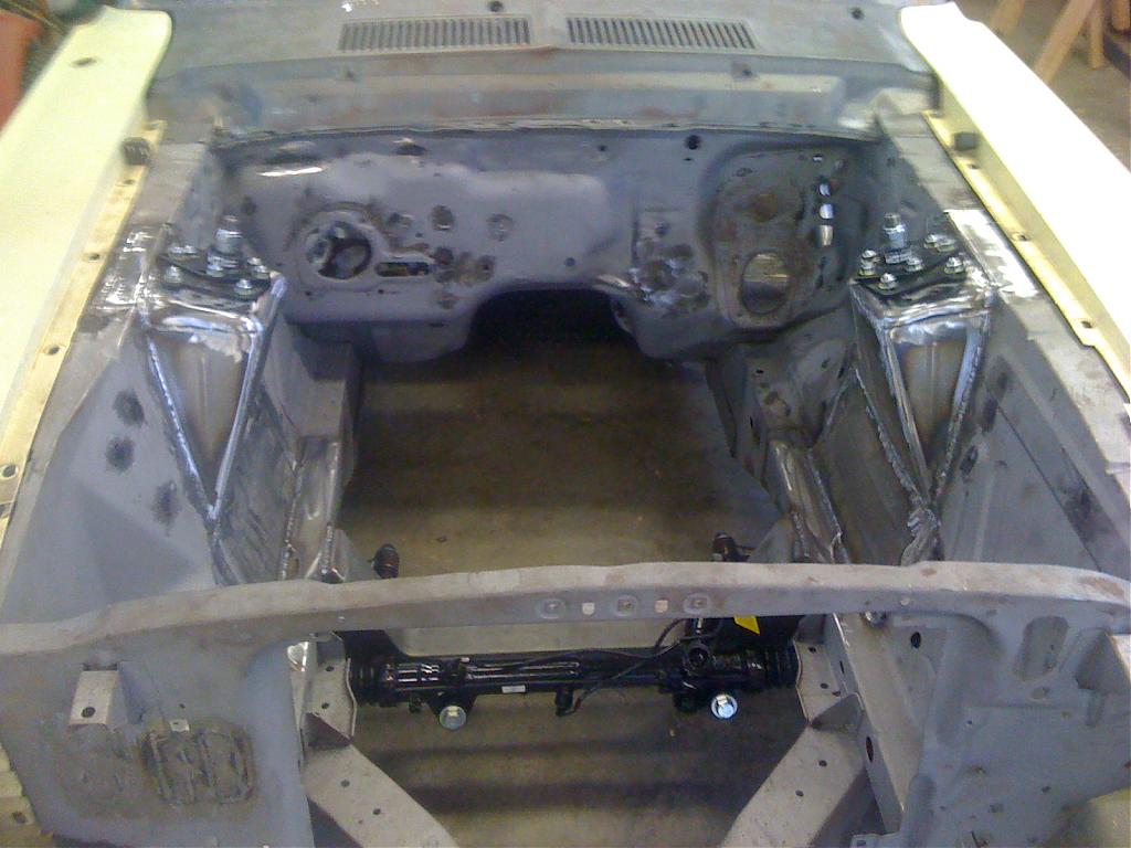

My car just got done over at Scott Moss's house. He finished up installing my suspension and roll cage and i couldnt ask for much more! Scotts been great help, and im glad he could get me set up so i can start throwing everything together on my car now! I've missed it everyday it was gone haha! Hope he doesnt get made for me posting pics before i grinded down and shaped up the shock towers, but this is the project section, and its still under construction haha! Plus his welds on the cross member and everything are pretty! Sorry the pictures are terrible, ill get some better ones and more in detail of the suspension here in a few days. We just unloaded it off the trailer and didnt have much time to mess around with it sadly. anyways specs are:
Mustang II cross member
Mustang II A Arms
SN95 spindles
Maximum motorsports MM3 custom bilstein struts with there coilover kit
front hypercoil spring rate 425
Maximum motorsports caster/camber plates

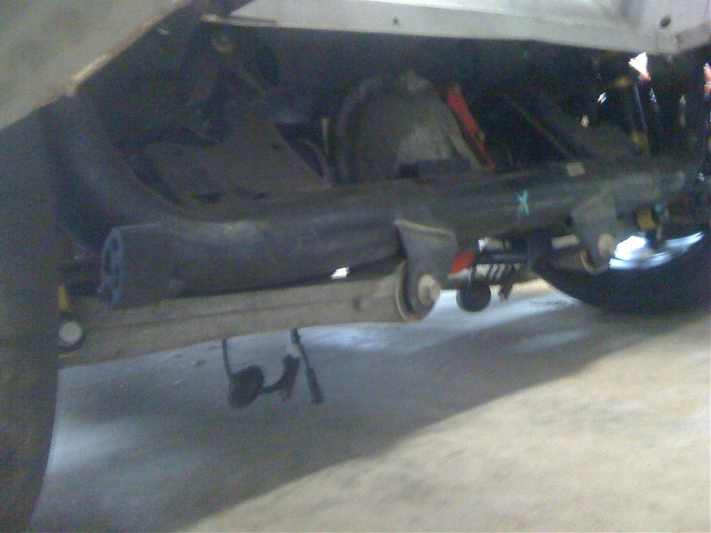

Rear suspension is out of 03-04 cobra (independant rear suspension)
MM's MM3 coilovers
rear hypercoil spring rate 700 (remember its IRS the road angle changes the spring rate in a sumed up way)
Maximum motorsports delrin bushings, tie rods, end links, etc soon to be installed probably during disassembly for paint, but thats sometime from now!
Scott used the upper shock towers from an 04 and fabbed the rest in. The rear shock towers he fabbed up completly from scratch. This came out really good and cant wait to keep trucking along to get this baby to the track to see how it works out. Should do just fine! (after some driving lessons/classes HAHA!) Ill post some better pics in detail of the suspension like i said here soon!

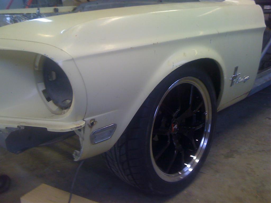

forgot to mention, no ride height hasnt been set at all! Its not even close, so dont judge yet! Plus fenders still need to be rolled, hopefuly Scott will let me barrow his eastwood roller so i can get that done here soon.

Jon the car looks good on the ground.Jon was great to work with. He gave the time work things out on the frt. suspension. Cant wait to see the thing run down the road.Thanks Scott Mock

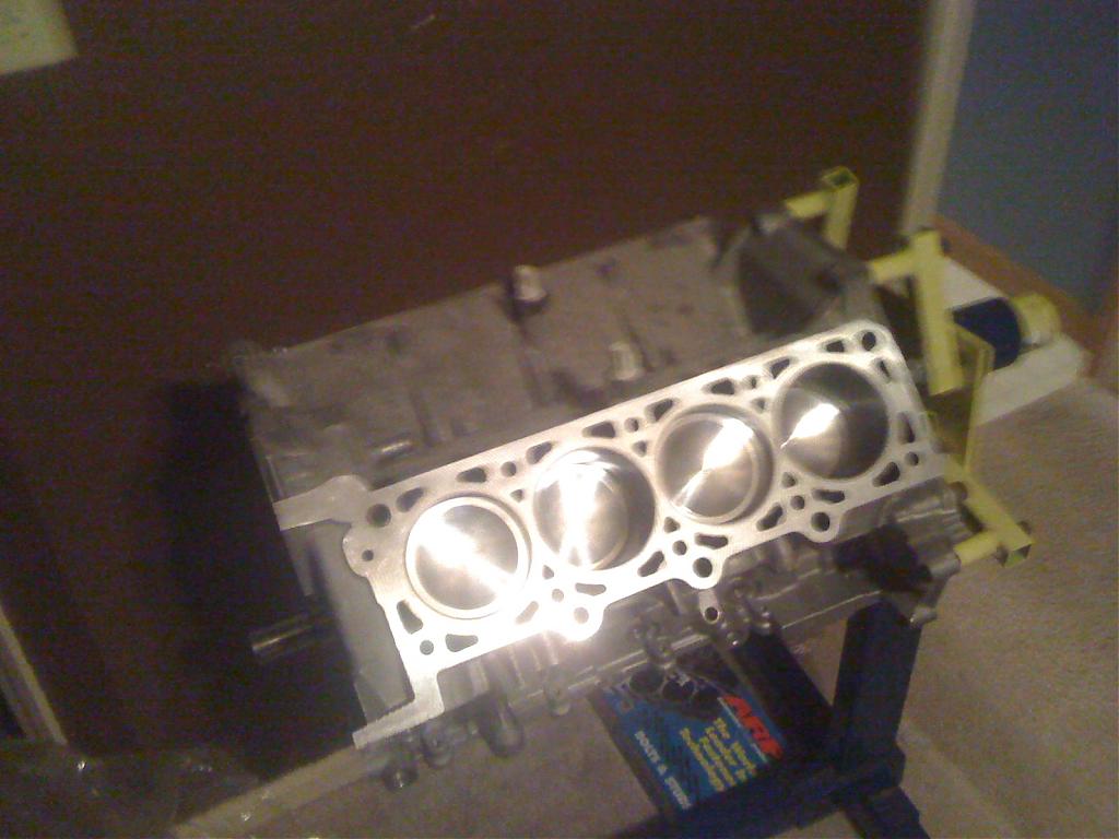

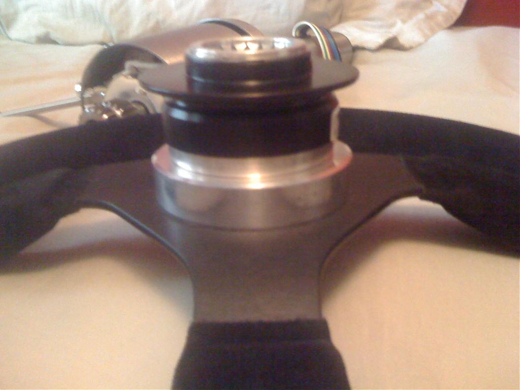

just a few pics of what ive done acouple weeks ago. The long block assemblied, and now its almost completely done. Modded the seat pans to sit lower to the floor, im 6' 4" so i need the extra headroom last but not lease scott mock fabbed up an adapter to solve my sparco 3 bolt pattern wheel to fit my grant 3 bolt pattern quick release. Ill update more of the recent stuff here soon
