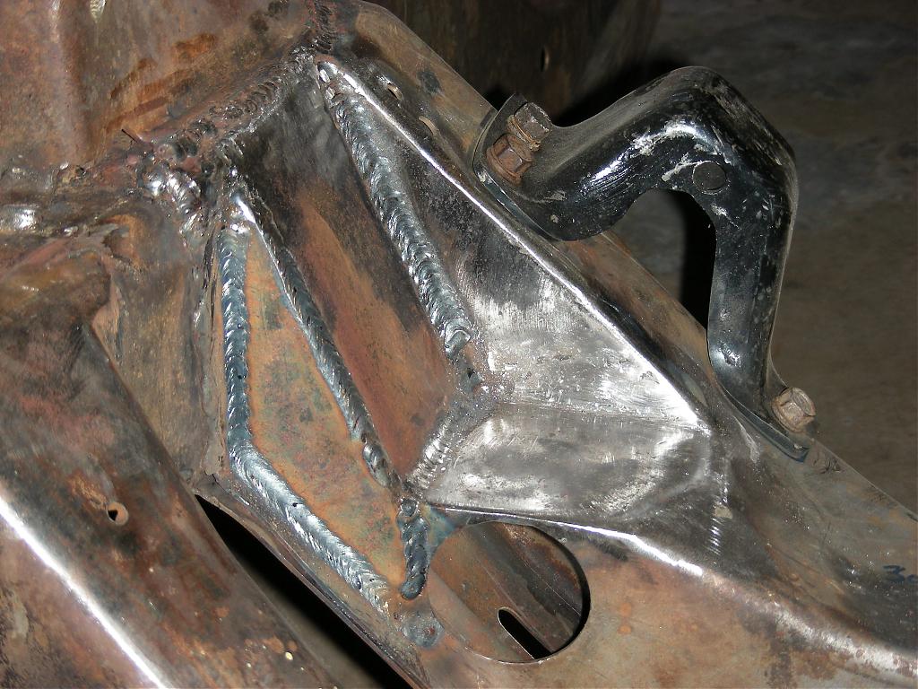

I don't weld that often but one thing that helps is just get in a comfortable position and do a mock run of the weld area before pulling the trigger.
Thanks your welds look good.
