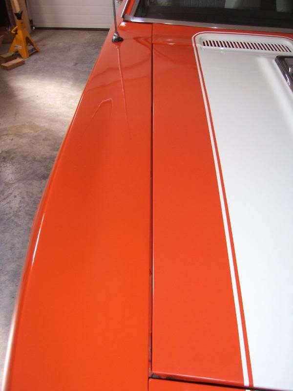

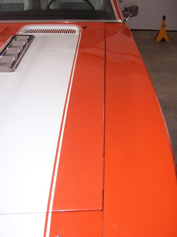

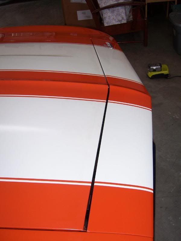

I got my new EMS hinges installed on the weekend, replacing my stockers. Fit with the originals was near perfect. I played with these new hinges for a few hours and have run out of solutions so am looking for fix ideas. My depth is perfect, side gaps are perfect. I have an issue with gap on the front of the hood with the header panel. Any adjustment ideas?

Not to be critical, but I don't think the fit was "perfect"with the stock hinges. If the back and side gaps are correct, you can only move the hood front and back. If you skew it the other gaps will suffer. Maybe it is an illusion, but in the drivers side picture the stripes line up. In the pass. side picture, they do not. That has nothing to do with the hinges. I have feeling you are looking more closely at these areas since you put the new hinges and maybe did not pay as close attention before. JMO, but pictures may be deceiving. Good luck! Hang in there.

It is hard to tell from the pictures what is off. Is there too much space, or is it not sitting flush, etc?

from the pics, it looks like the gap is tighter on the ds than on the pass. theres nothing the hinges can do. you can rack the hood, but its a give a little to take a little.
