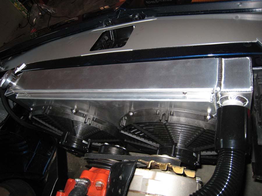

We picked up a dual pass Prodigy Cool Package for our BBC and its a real nice piece
