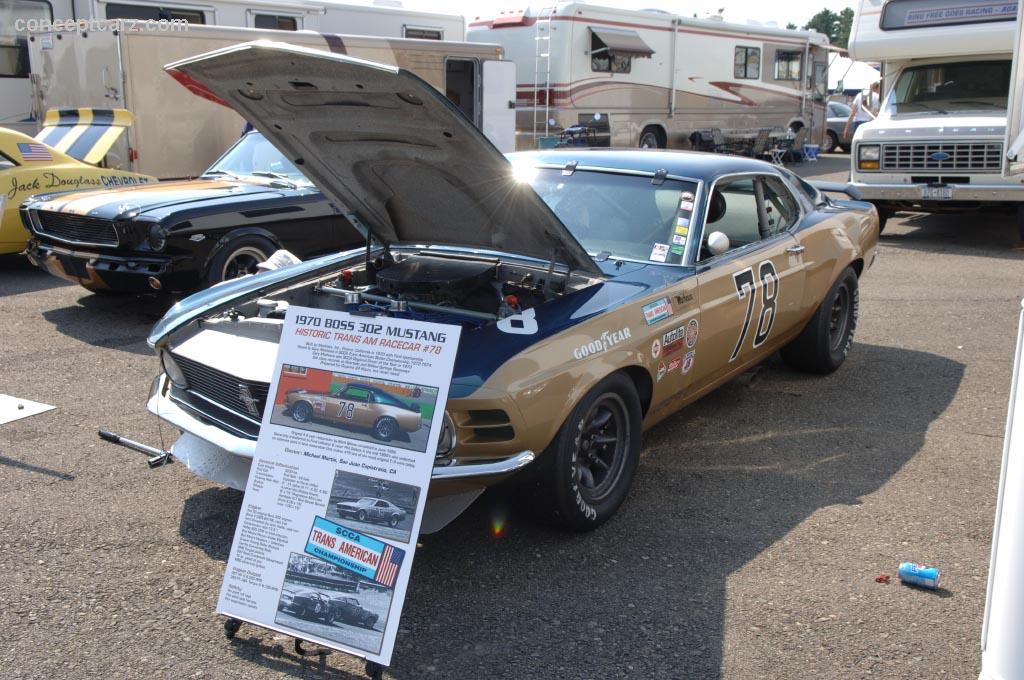

This should get you excited
http://shelbyautos.com/gallery.asp?car=Teroldmustang
I'm doing a 68 coupe. No joke, to do this correctly, is expensive. Check out www.streetortrack.com for a lot of components, ideas. www.cobranda.com has some stuff too.
