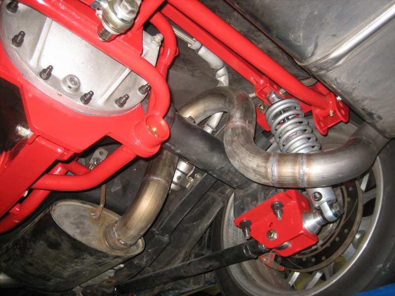

Do you have any pictures of a car with the BMR setup that has an exhaust routed? I am considering this setup, but I have concerns about what I would get into trying to get an exhaust through there. I don't recall seeing pictures of the Torque Arm / Watts Link / exhaust yet.

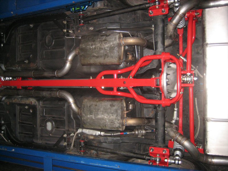

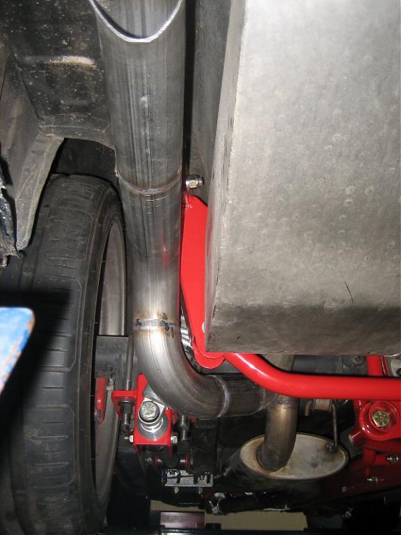

I have some pics of this setup on file. Hope this helps. I am not sure of the brand or size of the exhaust.
Thanx, those were helpful. Don't suppose you have any info on the wheel/tire size on this setup? Looks like the tire could get pretty close to the rear pipe depending on the width tire used...

I'm glad someone posted that setup with exhaust run. I was worried that there wouldn't be enough room to route the pipes. I'm not a fan of under the rear exhaust. Does anyone know how big the pipes are? I wanted to run 3" exhaust all the way out. Lee @ BMR told me that it will be tight but should be able to be done. Thanks for posting the photos.

Thats Lee's car from BMR! He is running 2.5" exhaust. Believe the car is also not mini tubbed. 3" is possible, all depends on ride height. Room runs out above the axle once you go lower. Its possible for sure, will just take some time, some brains, and some creative skills. We have the exhaust dumped before axle on both my car and Freedombird. The bird is getting all new exhaust again with 2.5" to try and clean it up and get is all the way back.
