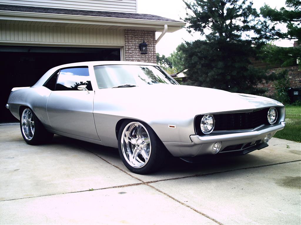

I sandblasted and powder coated my 1/4 glass.

Joe, nice car! I just added that mod to my list since I was blacking everything else out. Thanks guys.
Joe
Sharp looking car Joe.

Thanks for compliments, sorry for bad picture.

Yeah Joe. More pics, please....
