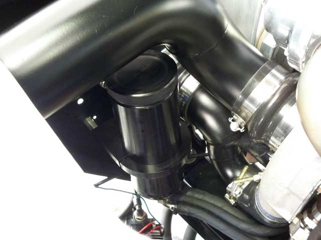

you still sell the reservoir you sold me? That worked great on mine, no noise and no aeration.
we have a bunch being made now. Made a couple production changes but otherwise they are still the same. Should have them ready to go after SEMA

perfect, worked fantastic.
