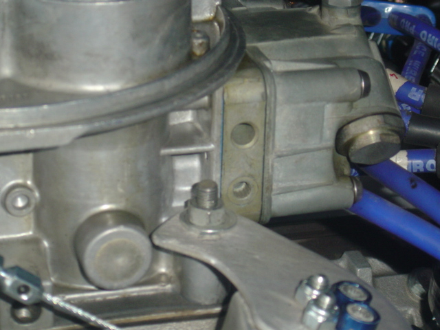

Thanks Jody....after further investigating......I found the rear to venturis are missing the idle adjustment screw. Could this lead to the problem as well or is this in addition. I got it running enough to get the car in the garage (slight hill where I live) and I smell of gasoline big time. I am not doing anything until I can get my hands on these screws. I think I may have 2 issues.
can you post a pic of what you're referring to? I'm confused...........

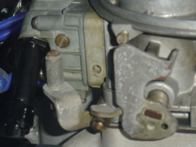

There are the 2 sides of the carb. You can see that the rear of the carb on both sides is missing the idle adjustment screw. At least that is what I think it is. Thanks for the input!!

there are a lot of four barrel Holleys that do not have secondary idle mixture adjustments. Those look like blank holes to me, like a screw could not even be installed. Take a close look and let us know.
I'm still recommending taking a look at the needle and seats for debris, as well as making sure the float levels are not too high.
