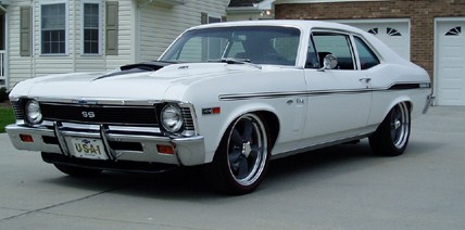

This is the car I'm trying to duplicate in terms of stance. I've got the exact same wheels (to the extent I can tell from the photo... I've got 18" American Racing CL205's) It looks to me like I need to drop the rear at least 1 or 2 inches and the front 2 to 3. BTW... anyone know this car?? I'd love to get this car's setup!
