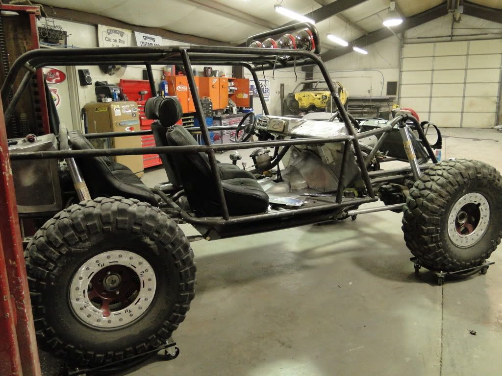

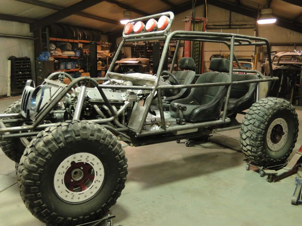

this is my new 4 seat rock crawler
6.0l , with ls6 ported heads , nitrous express intake ,fast efi , headers .
th400 trans , with a 4 speed atlas transfercase .
front and rear spidertrax axles ( 9in ) with 50 degree steering . high pinion front , standard rear , with 4.88 gears
4 link front and rear , with 7075t6 bars , shocks are nitrogen fox 2.5 .
tires are 39.5 red's BFG comp crawlers
guages are race pack
suspension seats
this will climb anything you point it up ! ( just wear you seatbelt )

Thats sweet Kenny. Where did the chassis come from ?
HRBS on Facebook
Old 12-30-2010, 07:30 AM
kennyd's Avatar
kennyd kennyd is offline
Join Date: Oct 2005
Location: nw arkansas
Posts: 917
we built it all

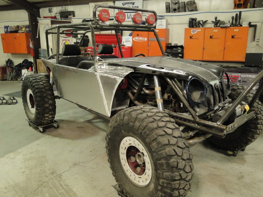

I want to go to the hammers , but i didn't build it to compete . My last one was a campbel ent 2 seat , it was more of a comp. rig than this .
This one cam compete in smaller events , but i would have to change to coilovers for hammers and longer events .

I understand. I honeslty thought the shocks were just mock up..hahaha
Are you running an Air shock on that?

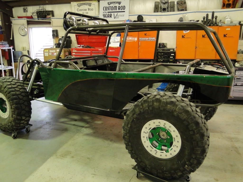

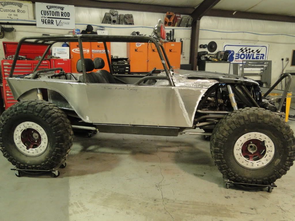

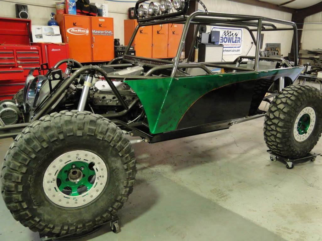

newer photos with the hood and sides
http://s1209.photobucket.com/albums/...5photos604.jpg
http://s1209.photobucket.com/albums/...5photos607.jpg
