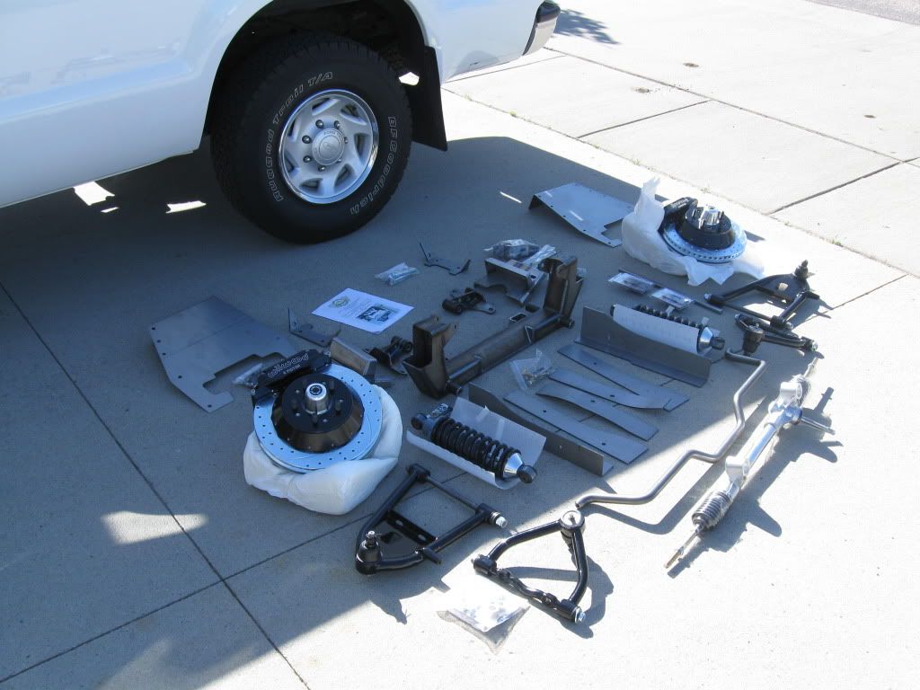

Per the PM.. posted some pics of the 67' project
The rear kit for 67/68 Mustang. They sell Currie third members but I will narrow my own.
TCI front end with 6 piston calipers

quite a stack of parts
