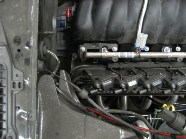

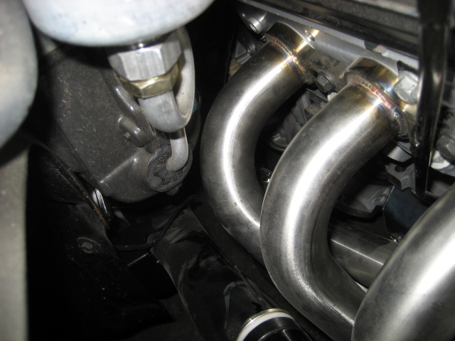

Here is a little more specific. DSE sets the motor back against the firewall. Overhead pic shows the interference with the box. We moved the motor foward to where the original motor sat and the cleared the box fine. Second pic shows the interference with the DSE header in the foward position. In this pic, the sub lacks about 4" before it mates to the body. Easy fix but cutting into the DSE header pains me to no end.
