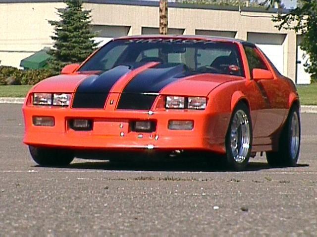

heres what ive been up to now time to make down pipes and then mount my wategates

Looks great, turbocharging is such a beautiful thing (both in theory and in practice).

Sweet! I love that body and thats defently the next car i buy(not yours dough ). I am thinking of buying my friend’s engine from a '89 and turbo charge.

very nice man...........very

What did you start with as a basis for the headers or are they completely custom? They look really nice and the turbos fit very nicely where they are. Would it be possible to keep the Air Conditioning unit, and also I have seen some headers on ebay, what did you think of those? I have had a couple of 3rd gens and I am itching for another one and it would really be nice to turbo it. Once again, nice work.

there 1 off headers and i plan on running A/C low on the pass side of the engine with a short water pump and a power steering pump on the head.
i have a set of the ebay one but with the large turbos im running i dident like where they sat (im running t-70's)

Would the ebay headers allow for all accessories to be in their normal location? If and when I ever do this, I will be going with smaller turbos so they should be adequate. Do you have any pics of the wheels that you have on the car? I can't tell much about them from the pics I have seen, it looks like the have a black center.
