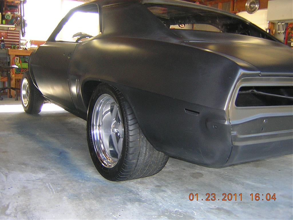

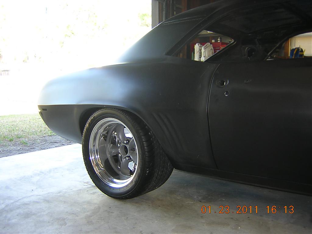

I just had mine mounted up. They are 17X11 with Michelin 335/35R17. I think they look great and don't have a lot of bulge.
I can't afford the three piece wheels so end up getting the TTII's for now.

that looks wicked!!!!!!!
