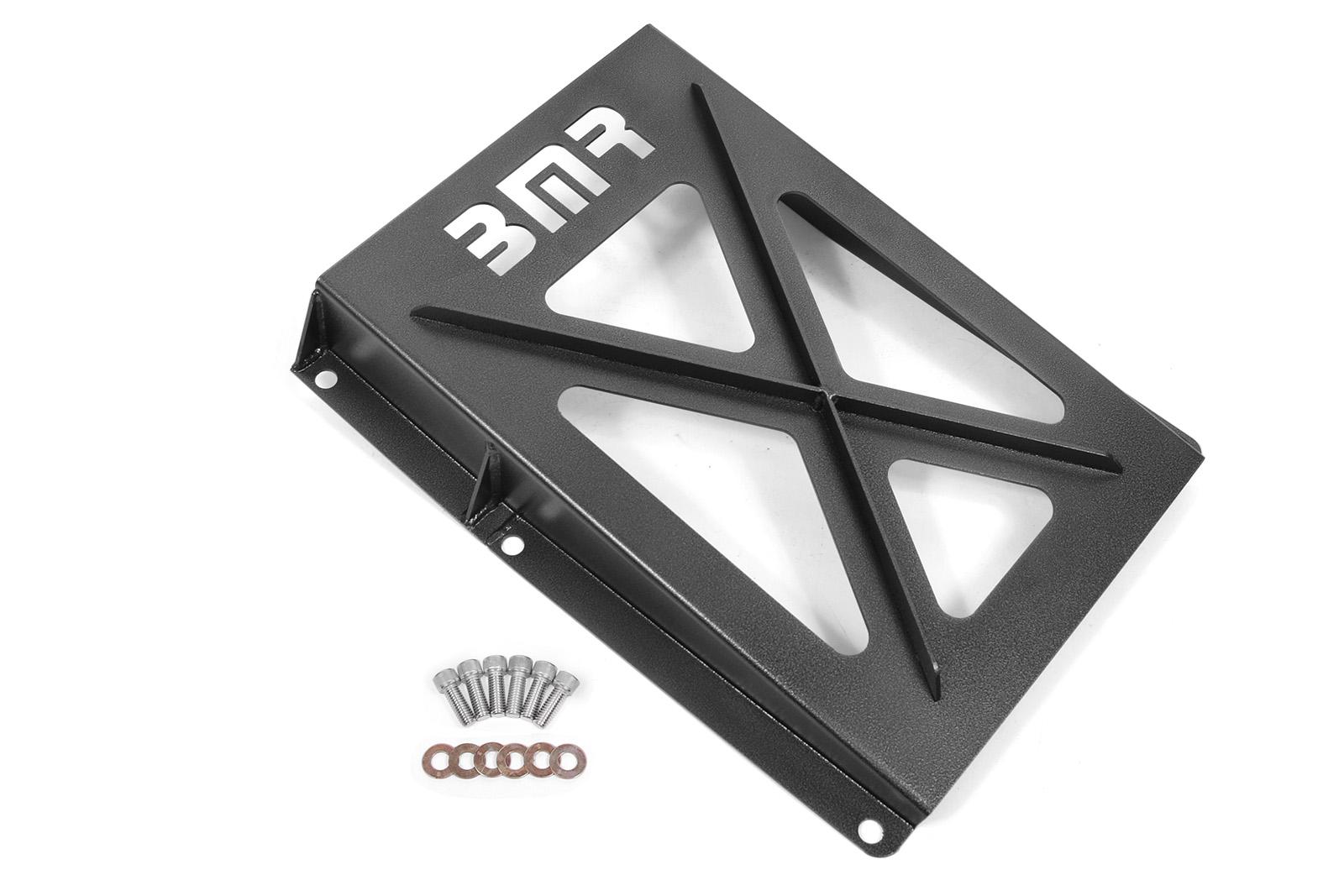

We also make a Tunnel Brace for the 67-69 F-Body Convertible. The design allows for up to a 3" exhaust and utilizes gussetted x-bracing to further strengthen the tunnel in this area. Installation is simple and all new Grade 8 hardware is included.
Brett
WWW.BMRSUSPENSION.COM
