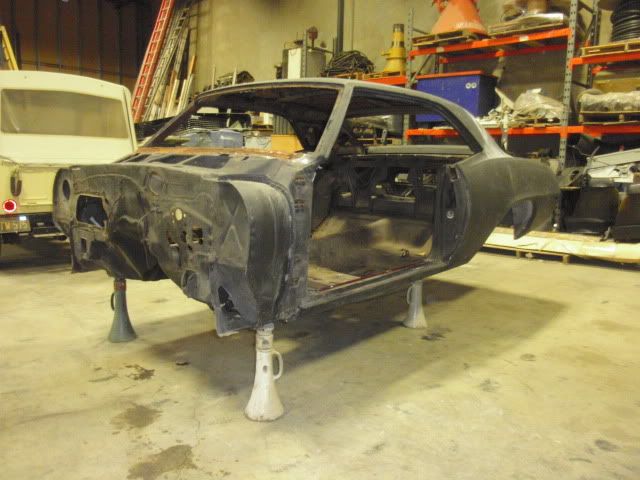

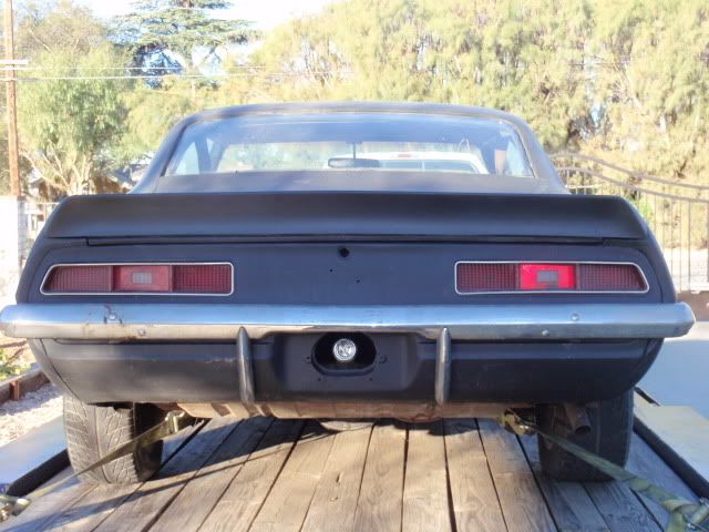

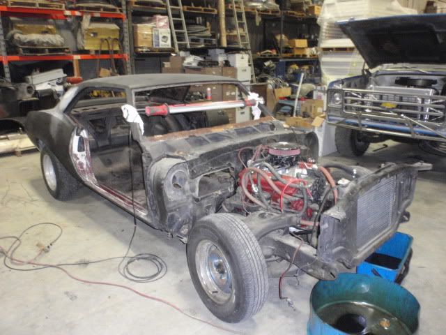

I took these pictures last weekend after I drove it into the shop.
Then I started working on it.

I moved your thread in hopes that your specific question gets answered faster from our suspension guys. Also, may I suggest you start a new thread in the Projects Forum where you can show updates starting with these pics of the tear down!! Welcome to the site and thanks for sharing!!
