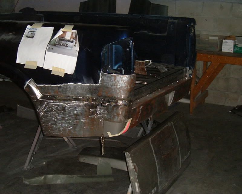

We are back working on this project. Brian finished welding on the bed

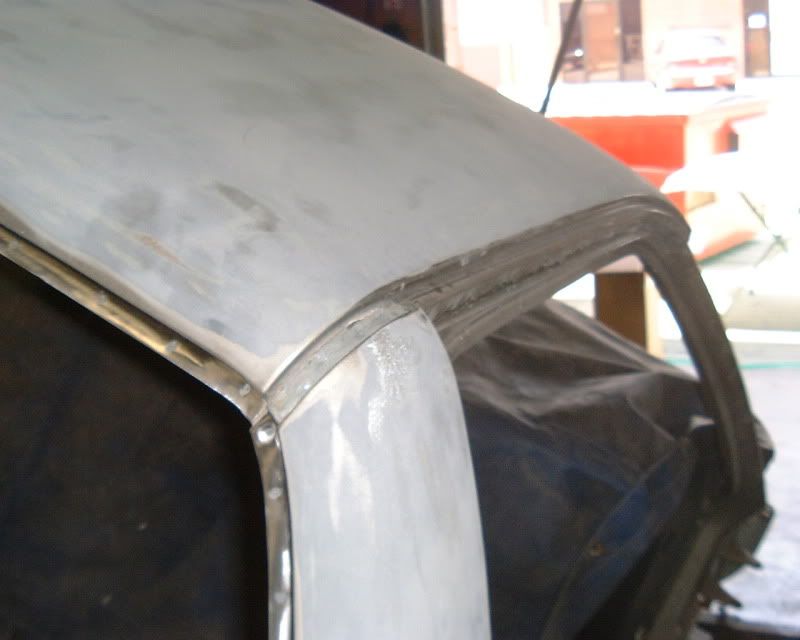

We modified the cab a little

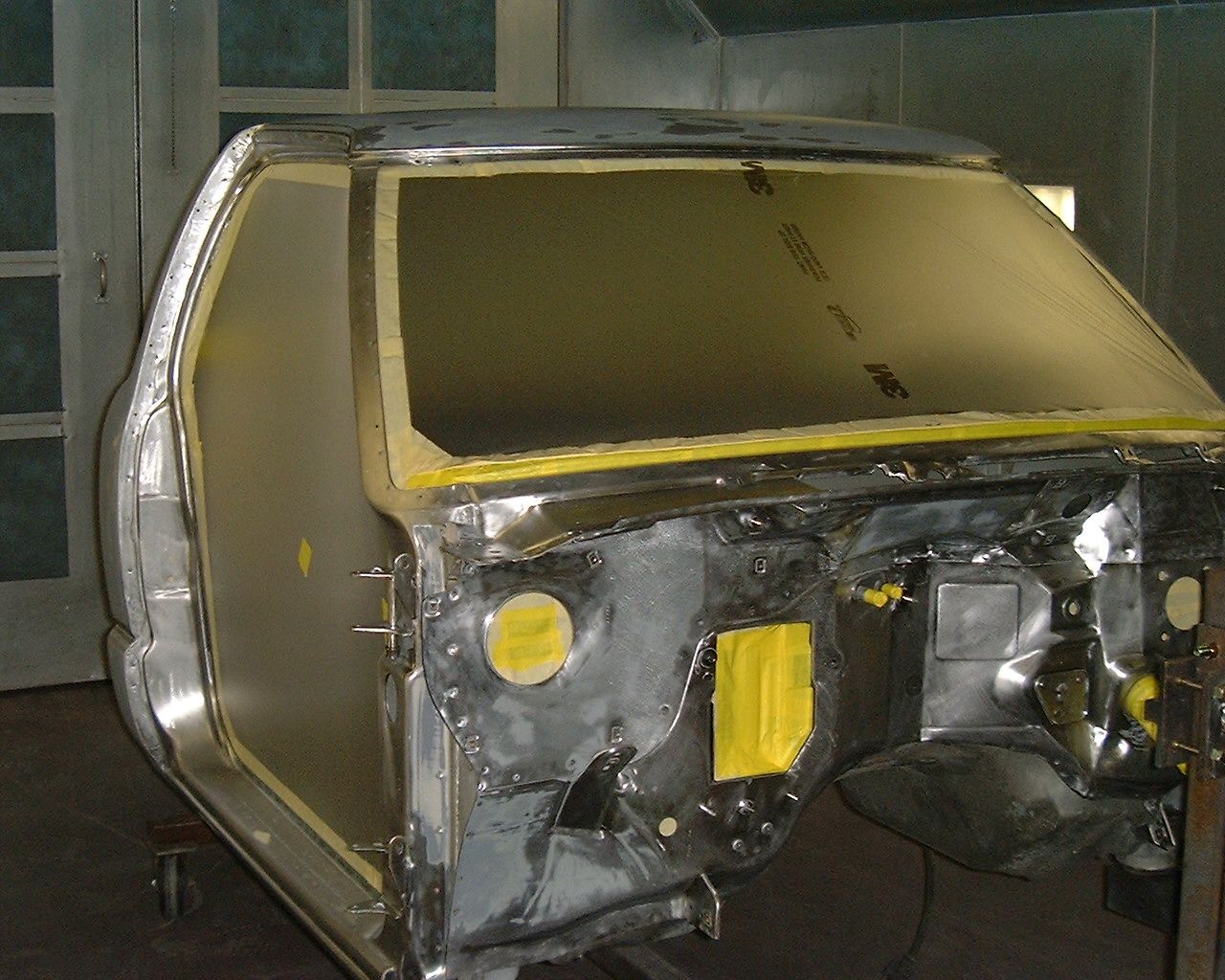

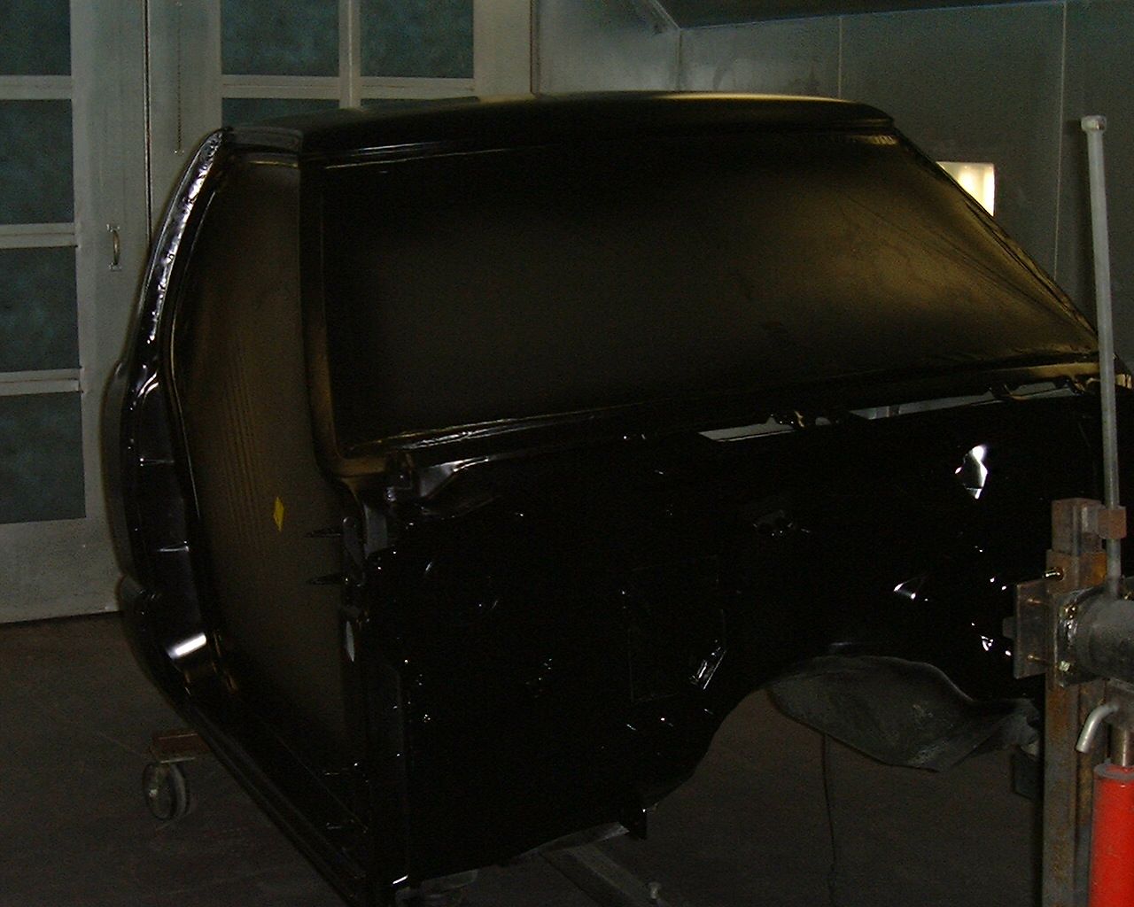

The cab had a little rust in the lower firewall on the right side that was cut out and repaired than we epoxy primed the cab

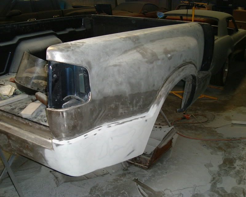

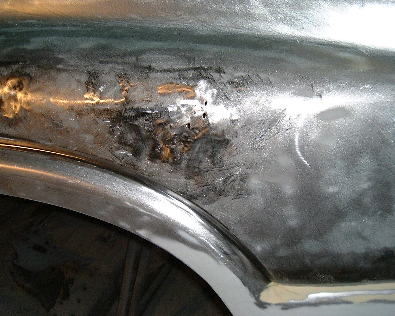

When I sanded the bed I found a few surprises that were filled with bondo.
Brian welded the holes than I did the bodywork. The bed is almost ready for primer.

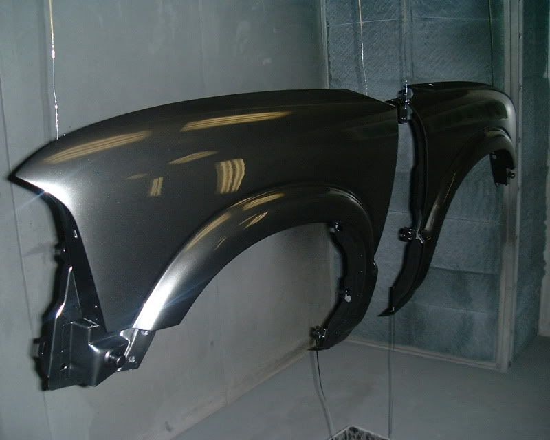

The fenders are painted. I sprayed 3 coats of 2011 Corvette Cyber gray yesterday and 3 coats of SPI Universal clear this morning.

Old 07-13-2011, 04:38 PM
DOOM's Avatar
DOOM DOOM is offline
Location: South Side Chicago
Posts: 2,912
Thanks: 7
Thanked 64 Times in 40 Posts
SPI is the only way to go!! Looks great!!!
