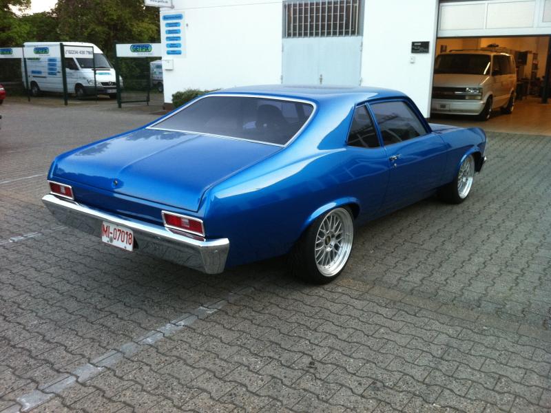

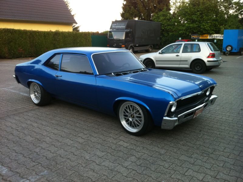

enough wrenching, today my nova saw daylight .....damn time after 11 years full resto.

(i am still lacking the cowl and some minor moldings i know i know .... hope you like it anyways)
