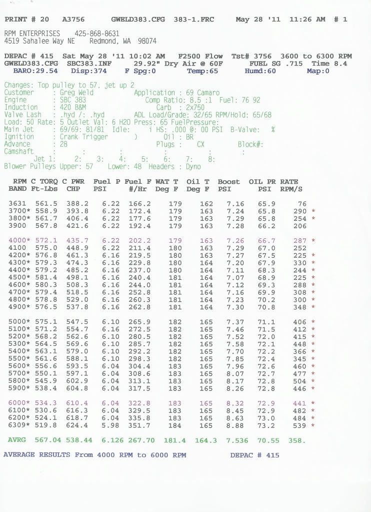

I'm re-doing my brother in laws Pro Street '69 Camaro... and had this motor built for him - using his blower and some parts I had laying around. It made 581 TQ @ 4500 and 624 HP @ 6300.... and idles like a stocker. Not bad for a pile of spare parts. I had the block and crank... and the Canfield 220 heads with T&D Machine shaft rockers. Roller cam... H beam rods - Mahle pistons.

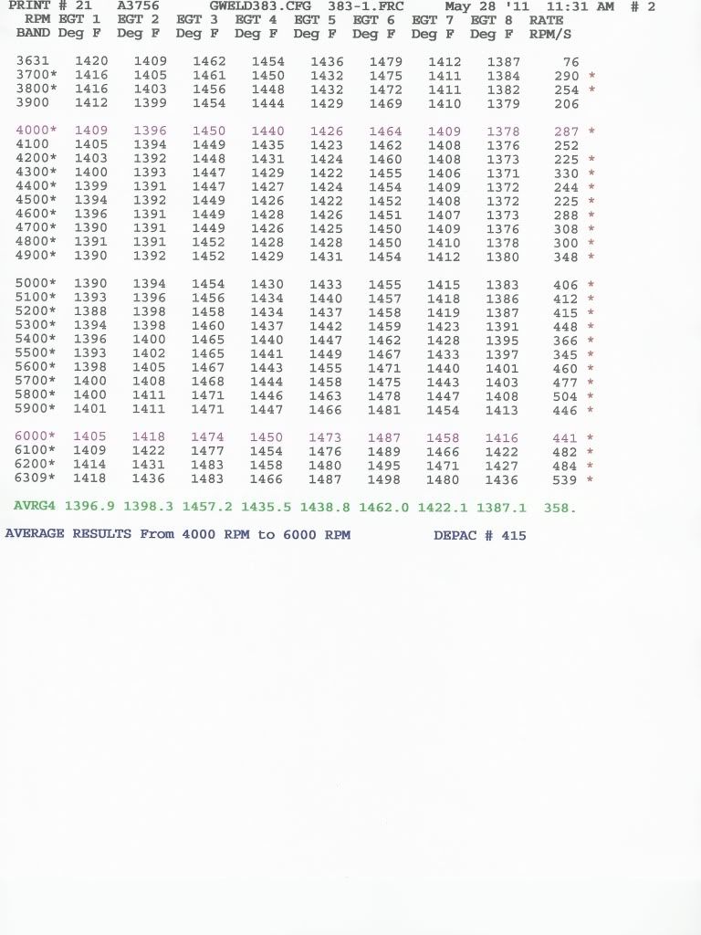

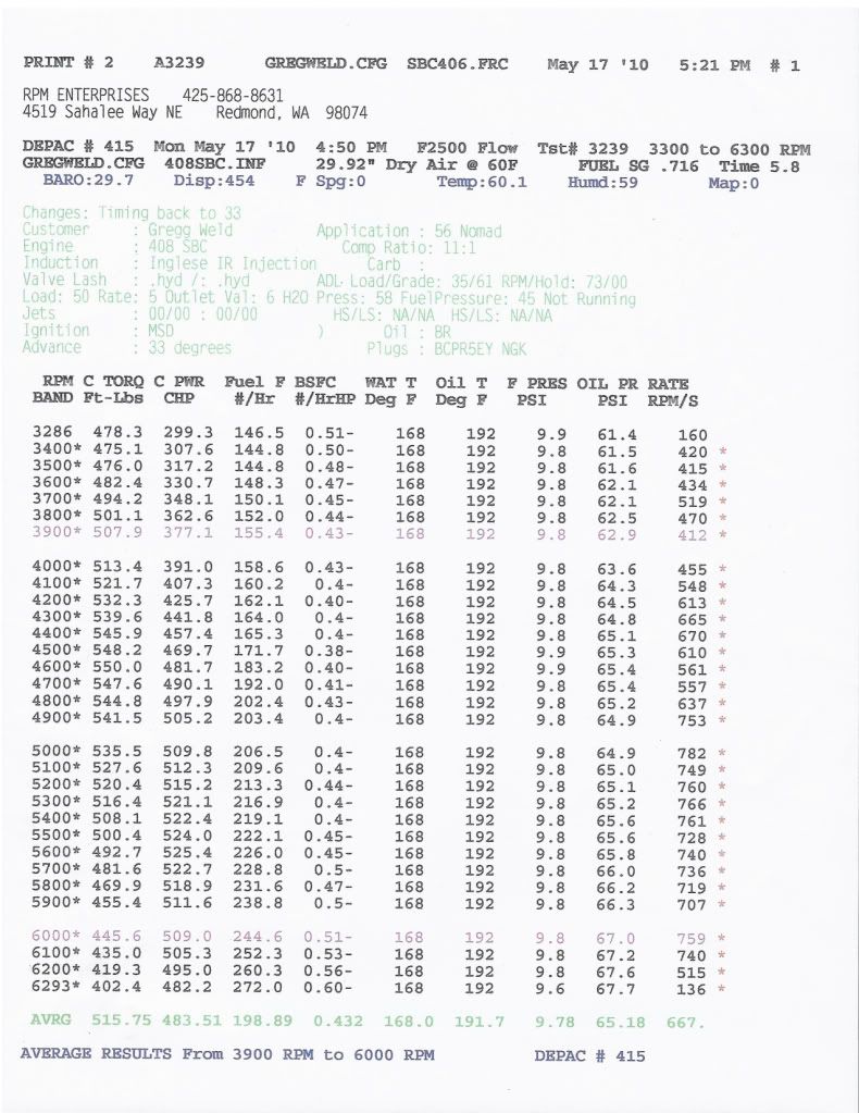

Dave -- You may or may not have read my post about it not being my first goat rodeo ---- and some comments I posted about a motors "rate of RPM"....
My 406 is done NASCAR style - Honda rod journal size - small rod end - with the reduction in reciprocating mass....
So check out the two dyno sheets comparing my longer arm 406 and the blown 383 - the FAR RIGHT column that shows RPM Rate of increase -- and compare it against the 383's.....
MY 406 8 stack:
The Blown 383:

I don't remember what thread it was in -- but the gist of the comment was that I spend a fair amount of time hanging around my buddies dyno... and that we "talk" a lot about these various motor builds. One of the things I'd learned was to pay attention to the "rate of rpm increase" -- not just the HP/TQ numbers. Sometimes Rick makes comments about a motor being "lazy" - or about how killer it's going to be so asked him to explain that to me.. and the rate of rpm increase was a 'clue' to the other aspect of an engine build that is important.
That - of course - like most engine building - is based on many factors - reciprocating mass - head/port sizes - and on and on.... The motor in the Nomad was built with this in mind... and the best description of that motor is "snappy". The lightweight reciprocating mass - and the small Dart heads - and the IR intake adds up to a pretty quick rate of increase. Makes it super fun to drive! Torquey and super 'responsive'.

Thanks! For a 'cobbled' together (somewhat) bunch of parts laying around... it will make a very nice street motor for him. At 7 lbs of boost - it'll live... and it has good stuff for guts. Forged crank - H beam rods - Mahle pistons - special Crane cam (harder core with pressed on gear) - the Canfield heads with the raised port can use the air the blower is pushing down it's throat... and the shaft rockers are stable...
