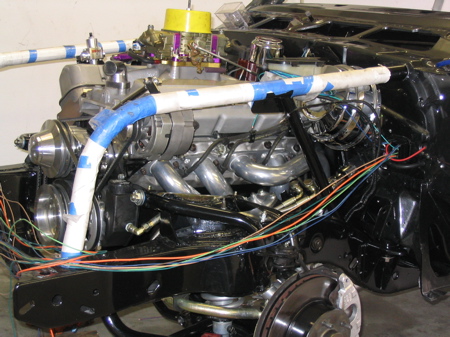

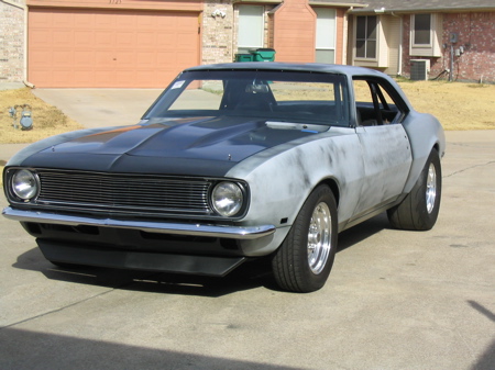

its been 1 yr of solid work (after hrs) in my garage and i'm just now able to take some time to post some pics.had to hire some help to learn more about iphoto,files,theads, posts ect.ect. i have about 250 photos prior to paint. if i remember how to do this i'll be posting more.praise lord i can see the light!

looks awesome your getting closer!

I like the grill, and the interior is shaping up nicely too.

what color are you painting it?the car is going to be bad

That's gonna be a nice car! When you get a chance, It'd be nice to hear a recap of all the mods you've done to it.

Nice look... That should be one tough ride.

Allright another '67-'68, only another 1599 and we catch up with the '69 guys!! Yeah what color? Everything looks great, and as Bill said we want details!!

the camtender the camtender is offline
Location: dallas texas
Posts: 109
Default more info on the camtender
motor:509 (crate502 .30 over)reworked heads,much bigger cam.300 shot nitrous.turbo 400 trans hooked to a moser built ford 9" rearend.global west front upper & lower a arms.dse rear mini tub kit.18 pt.roll cage insalled when i had car apart for new sheet metal,qts.tail panel,trunk pan,roof.all rear seams are welded smooth.a 3 nozzle safecraft fire bottle system is mounted in trunk.flaming river tilt steering column,95 camaro front seats covered in new leather,stock center console has carbon fiber faux finish done by vs finishes.other than switch panel and a few extra guages the rest of the interior is pretty much stock form.paint color is a lexus graphite grey pearl matallic (dark charcoal),with bright silver z28 strips.will be running on 15" wheels and adaquit brakes until savings account recovers.got go for now.will keep posting lastest.jerry
