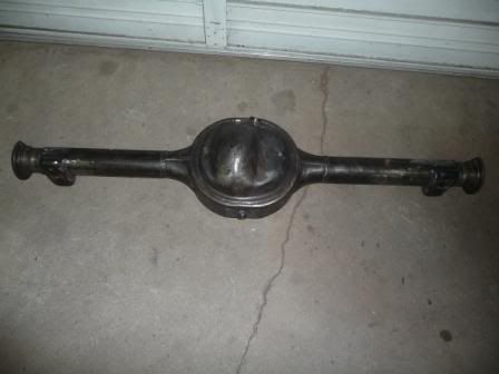

Also when looking for a rear end some of the housings have tapered tubes. Thats what you want.
They also come like this. Tubes usually aren't as thick and not as strong as above.
