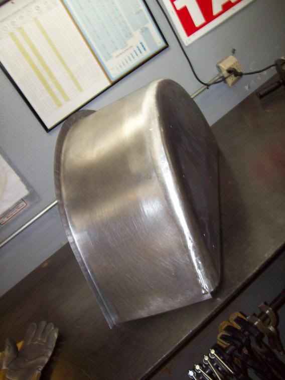

Do you use a beadroller and roll a radius onto the "vertical" part? I was thinking that would be how because if you do the other part you would have to shrink the entire edge, I have a mittler bros beadroller but no radius dies, what is recommended?

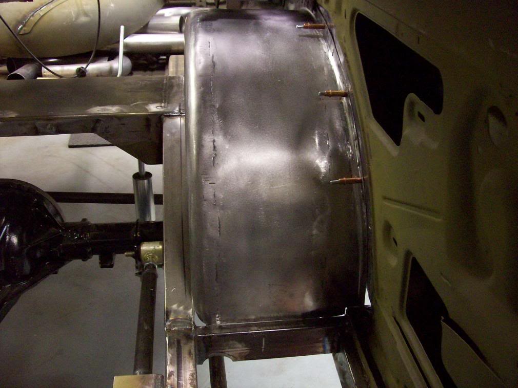

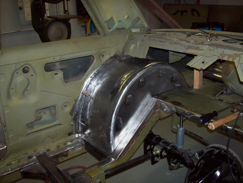

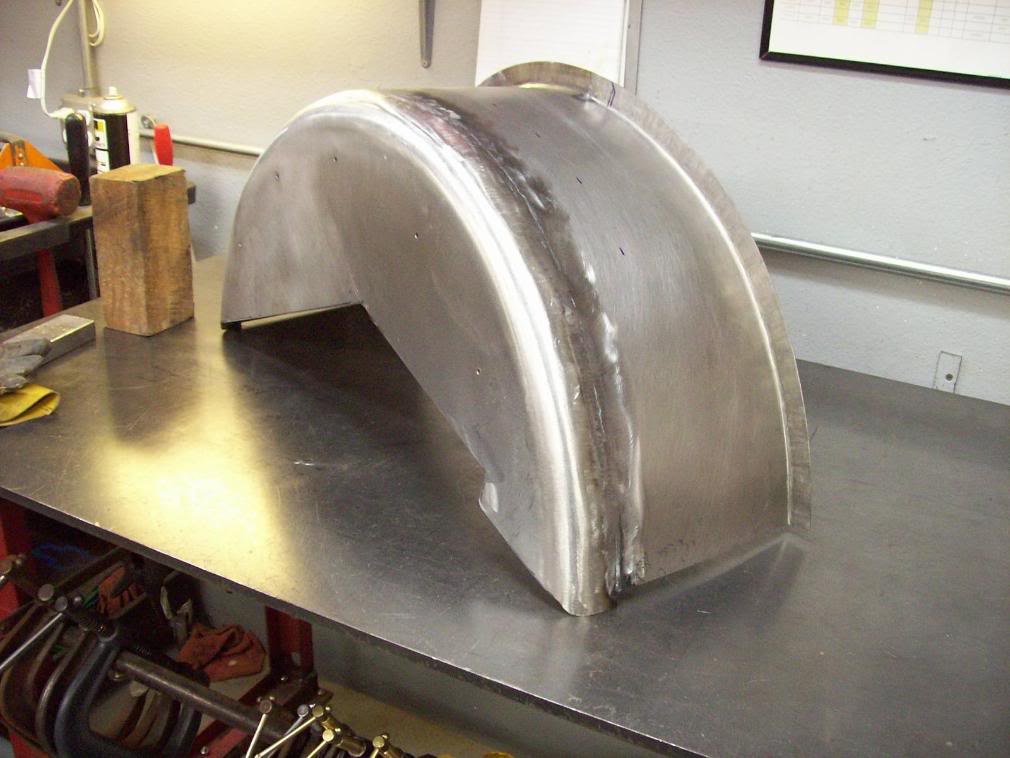

i did mine the hard way. i started with a 4" strip, rounded it over with a form that had been radiused, shrunk the edge to get the shape close, and then used a puck/form to get it the rest of the way. once i had the sides i used a flat sheet to close in the top and sides. mine werent as nice as the pro shops, but it was my first effort.

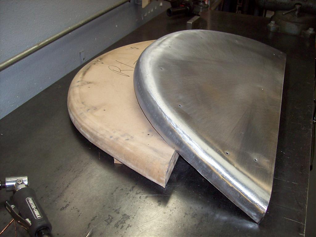

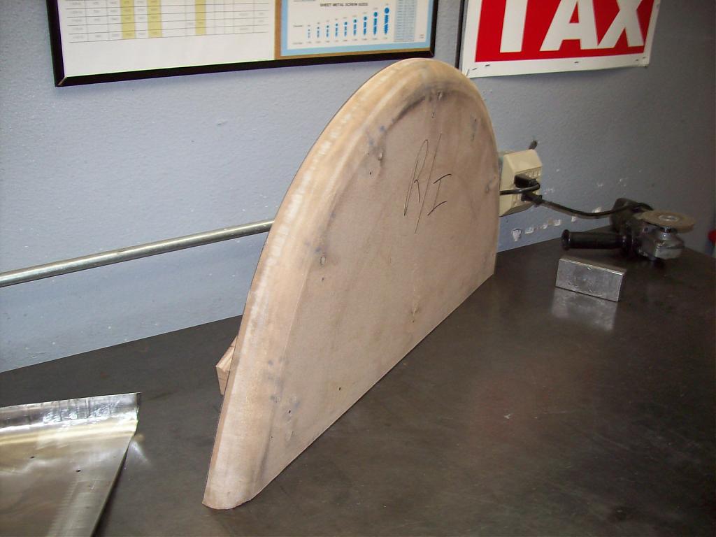

I did mine hammer form style and with only 2 pieces of sheet metal. I made a buck from MDF board shaped and sized to the piece I wanted. I use a router and a large radius bit on the buck. There more pictures in my Photobucket that is linked in my profile.

That's a great idea with the MDF buck, do you use a polyurethane hammer or a body hammer? Did you have to shrink or anything?
i did the same for my buck. i made my thick enough that i could route both sides since i didht have a symetrical tub and i couldnt just use one side.
im amazed at how well that turned out without shrinking. wish i would have seen that before.

The only Shrinking/Stretching I did on mine was for the flange where it attached the the stock panels. I did make two bucks but the inner buck from the right side will be the outer buck for the left side.
