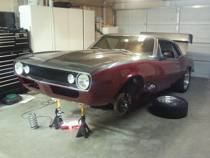

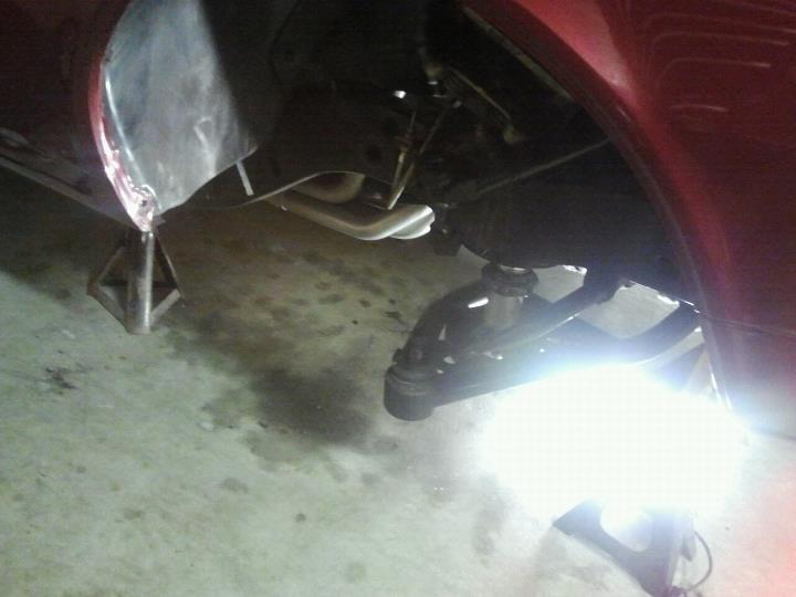

So I purchased the ridetech Tru Turn system and am trying to install myself. We will see how that goes. I recieved my parts from Ridetech nicely wrapped. So I jacked the car up and got started. I was able to get the right side off last night, going to try and get the left Wednesday night. Plan is to get it put back together this weekend.

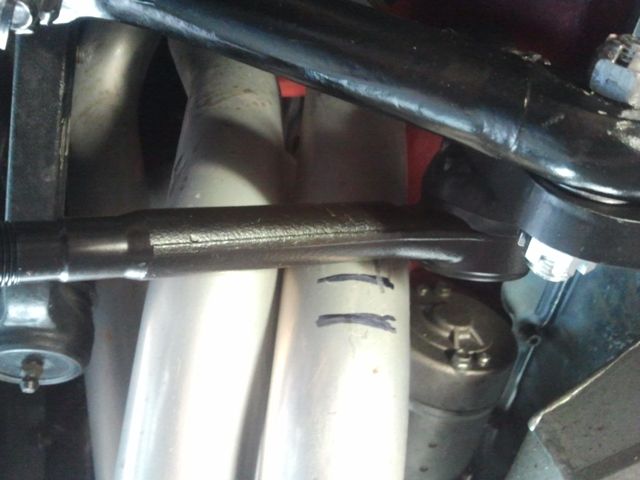

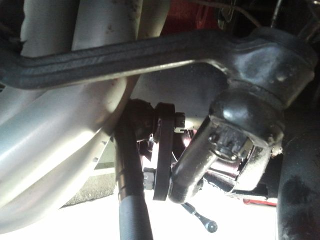

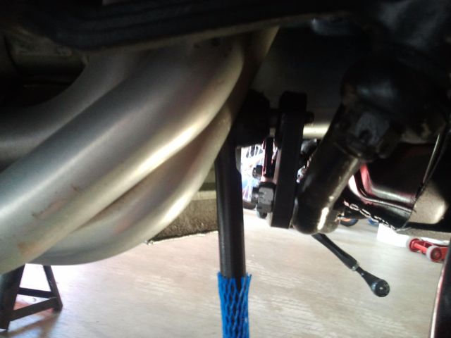

Well the relocated inner tie rods hits my headers. I am running a 383 SBC with super comp headers. I think the only way for me to use this system is to reroute my header tube.
Ridetech has ben great at trying to figure out a solution.

No way to dimple, it would collapse the tube 1/2 the way.
Allen and I found that Dynatech headers fit kick ass and fits the Ridetech Tru Turn system with ZERO issues, plus having a 1 3/4" to 1 7/8" step is an added bonus. They are also designed to fit around the 670 boxes. The Dynatech stuff is built very well.
