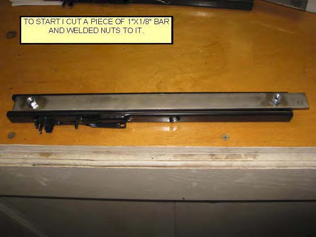

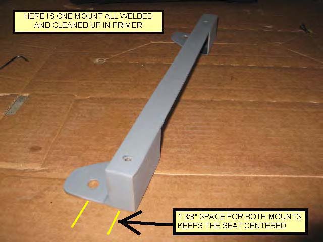

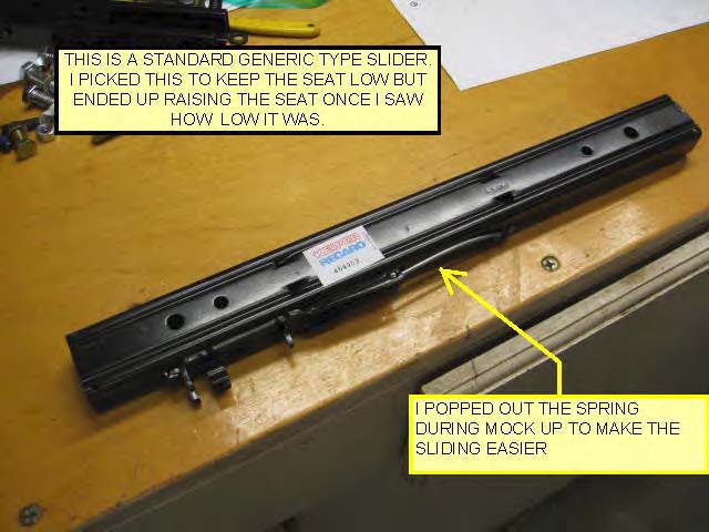

For all those considering installing recaros in their 68 camaro here is peak of how they fit. There are many ways to mount the seat. They may sell custom camaro seat brackets but as you will see I built my own.
