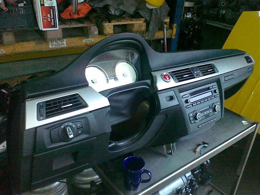

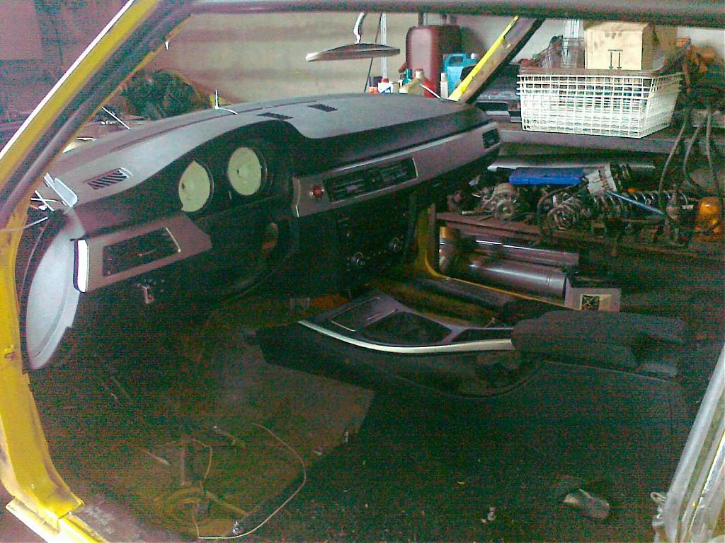

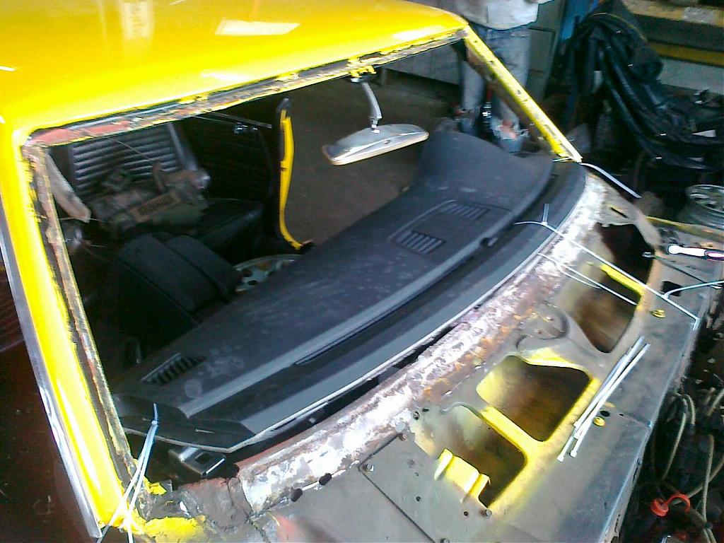

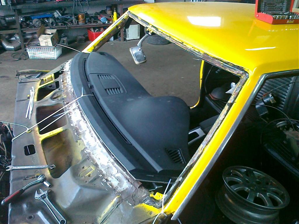

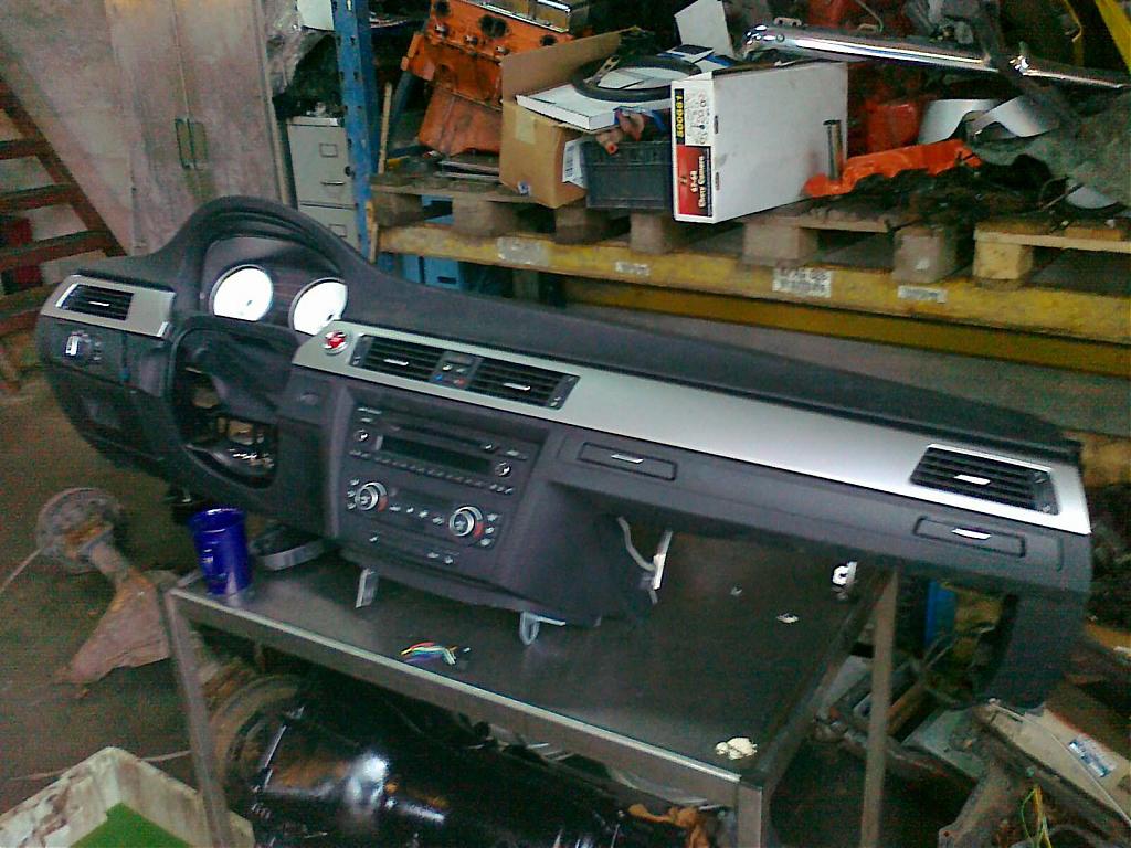

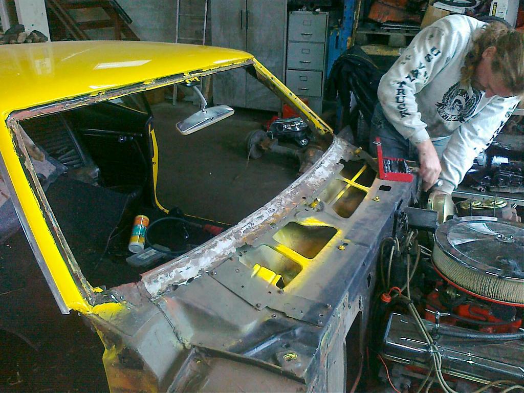

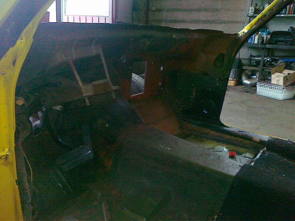

Hi guys! I saw there was another thread on here with a guy asking about a conversion like this one. We`ve just started doing this on my 69 camaro, and it seems that the dash fits pretty well so far:-) A whole lot of work since we also found a lot of rust and bondo below the new top of the dash that at first sight looked really nice, but no....... The pics are in random order though....:-)

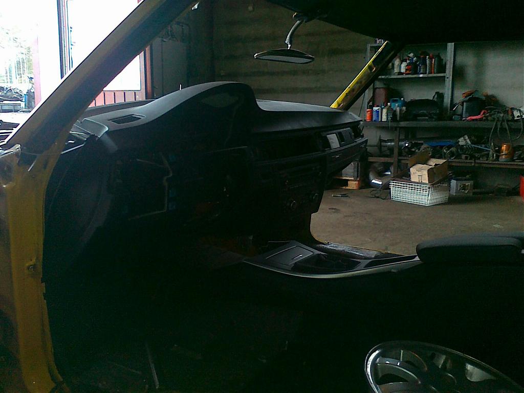

So far it seems that the outer edge of the dash needs to be trimmed an inch or so because otherwise the dash will sit to far against the driver. We will trim off an inch for starters tomorrow and see how it turns out. The sides fits pretty well- probably need to trim and recess the doors 1/2 inch or so to clear, but no big deal:-)

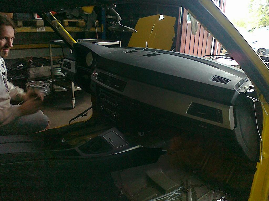

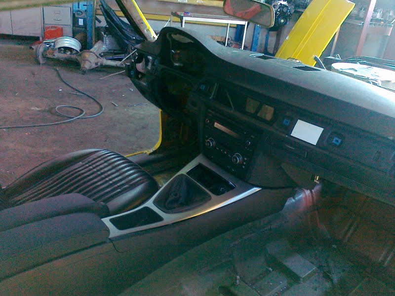

Here`s one pic from yesterday. We finally tacked up all mounting brackets and was able to put everything together to see how it turns out. We actually cut out most of the driveshaft tunnel from the donor car and mounted it more or less on top of my original one. This is because i am going to use the handbrake unit also, and wanted it to sit properly like in the donor. Also the console needed to be lifted a few inches to line up with the dash, so we figured it would be the easiest way to do it.

Looking real good... I may use the same approach as I like this alot. Are you thinking about using e9x door panels too?

Not really sure about the door panels yet. Seems there will be some interference dash-wise against the door panels, but will address that later. Small issue anyways IMO:-)

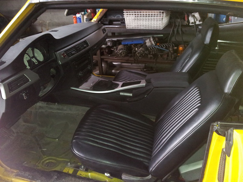

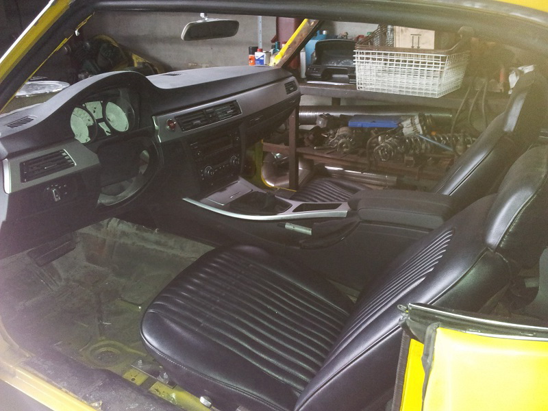

Had to put in most of the little things like glove compartment, gauge bezel,seats etc to get a more completed view...:-)
